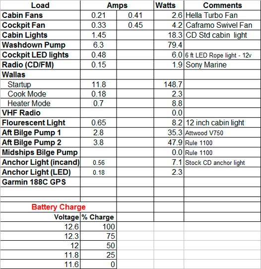

PostPosted: Fri Nov 07, 2008 9:02 pm    Post subject: Reply with quote
We talked about this sometime back, a few mnths, maybe.
I suggested that fluorescents were a very efficient bright alternative if you like lots of light for still negligible battery drain:
Cabin Lighting
LED interior and nav lights
Rope lighting uses, cockpit and cabin
Power Consumption Chart
Thanks to Richard and Sea Eagle
