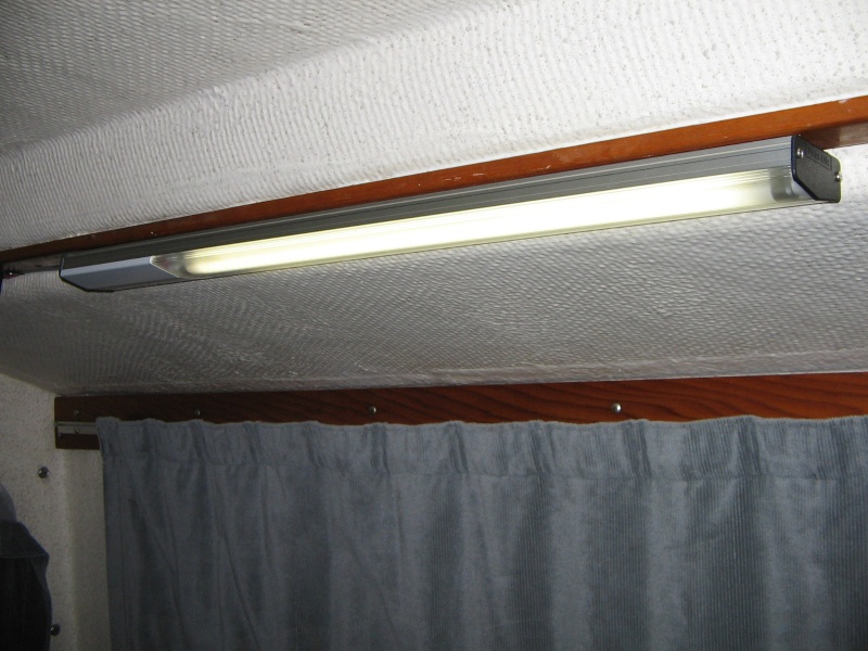

I just installed a new cabin light. It is a 13 watt fluorescent Thin Lite model 173 and is bright. Size is 26 5/8 x 2 3/8 x 1 1/8 in.
It replaces an 8 watt fluorescent that expired after 15 years of use.
There are three pictures in my photo album on page 8.
Larry H

Does the florescent light work on 12 volt or 110?
Thanks for the pics!

The Thin Lite 173 is 12 volts at 1.3 amps.
PostPosted: Mon Mar 20, 2006 3:26 am    Post subject: Reply with quote
The flourescents are great on boats! Very little amperage drain, and tons of light! Ihave a 16 watt one above the door on my CD-22 (2 x 8 watt tubes). Lights up the whole interior like daytime. No interference with other electronic devices, either. Joe.
