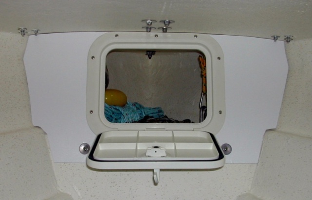

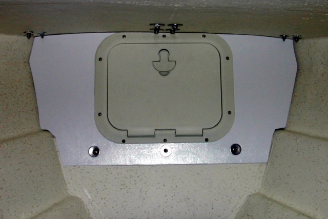

PostPosted: Tue Nov 04, 2008 9:06 pm    Post subject: Reply with quote
I followed Ken's example, but with a bomar hatch for access.
