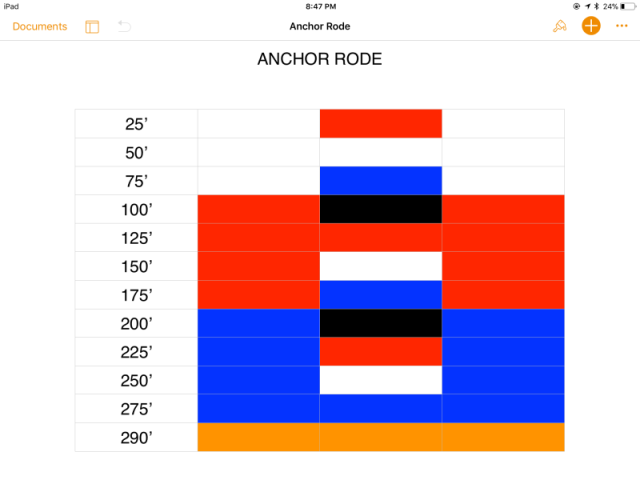

When I get better service I’ll attach a photo of the chart I use for quick reference. 25’, 50’ and 75’ are always red, white and blue respectively.
At the 100’ series the painted rode is three feet long so 125’ is 12”Red, 12”Red, 12”Red. 150’ is 12”Red, 12”White, 12”Red. 175’ is Red, Blue, Red. A pic is worth a thousand words but we are in the Broken Group Islands with limited service. We are anchored in 50’ of water so for a minimum of 3:1, I tied off at Red, White, Red. Hope this helps. Ken

Harvey. Here is the anchor rode scheme I use that you had asked about. So each 25' increment is red, white, blue. Note that each 100' increment has a black center to indicate 100', 200', etc. The hundreds of feet also is red, white, and blue. I only carry 300' total so the orange warns of the end of the rode. I also have a mark on the chain that warns me of the anchor just before it hits the roller. Ken

Ken, Thanks for the chart. I have used paint but it is mostly gone after 2 years heavy use. As to the lenghts, at 50 feet for the first marking I would be almost fully at the end of my line Wink
My typical depth for anchoring is at 5 feet at low tide, and I would usually run out 70 feet of chain, prefering to not run onto the 200 feet of rode.
