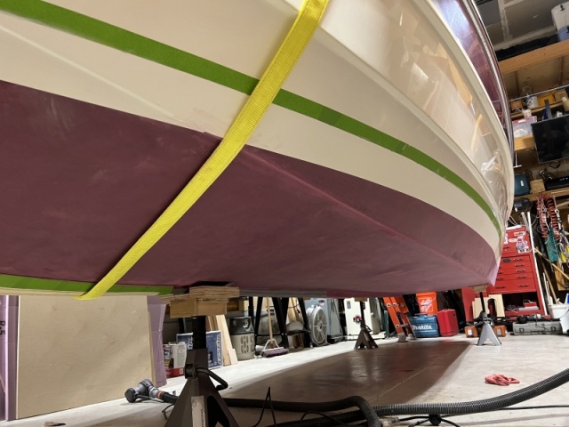

First coat of epoxy.

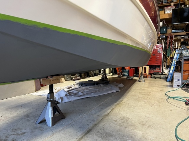

I put the second coat of epoxy on and here is some info that might be useful.
Two coats and I have reached 10 mils of thickness. The can says you want to be 12 mils thick for the barrier coat to do its job.
It takes 2 quarts to do the bottom of the boat so a gallon will do two coats.
I am going to put the third coat on today and will see where that puts me. I was planing on at least 4 coats.

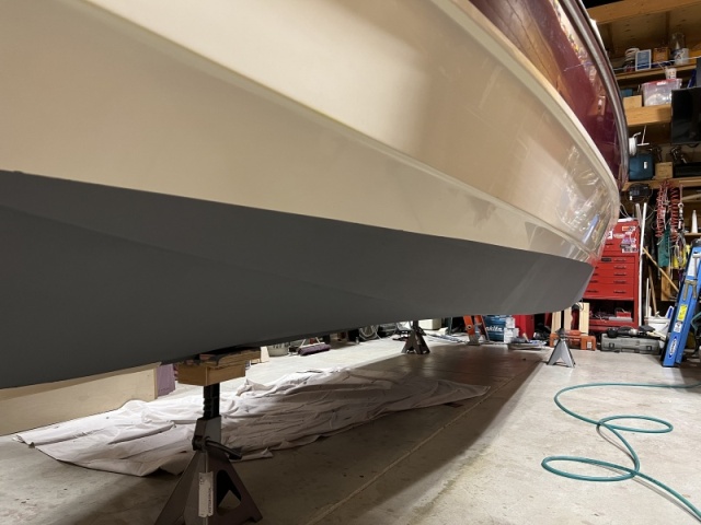

4 coats and the epoxy is done.

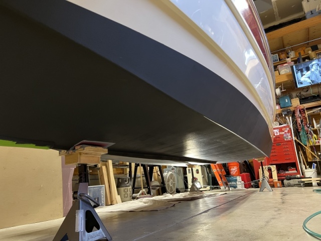

PostPosted: Tue Jan 25, 2022 12:42 pm    Post subject: Reply with quote
Ok the bottom paint is on and the only thing left to do is move the stands and do the whole process again on the 3 8X8 spots.

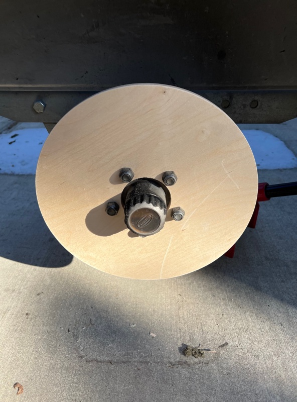

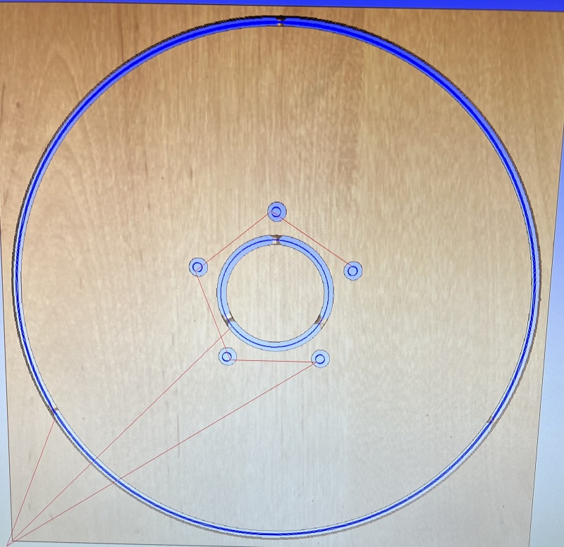

All of the bottom paint is finished. Started making the new wheels to put the trailer under the boat again. It took about a half a day to get trailer out from under the boat with flat tires ( they don't roll very well when all 4 are flat) had to winch it out from under the boat. New wheels are 1/2" baltic birch plywood.
