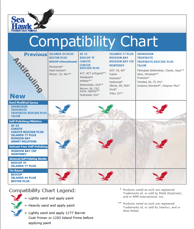

I am interested in using this new Sea Hawk paint on my boat and I currently have Interlux ACT, an ablative, on the boat bottom. (wears away like a bar of soap)
I contacted the Sea Hawk factory who sent me to a Seattle area tech rep. The rep said, yes, sand and apply. The Smart Solution paint is an ablative, so the existing paint can be the base for the new. If the color is slightly different, you can tell when the new paint has worn away.
It looks like this copper free stuff will be the wave of the future.

PostPosted: Sun Feb 06, 2011 3:06 pm    Post subject: Reply with quote
RE: Sea Hawk bottom paint compatibility.
Here is a copy of the chart from the Sea Hawk website.
