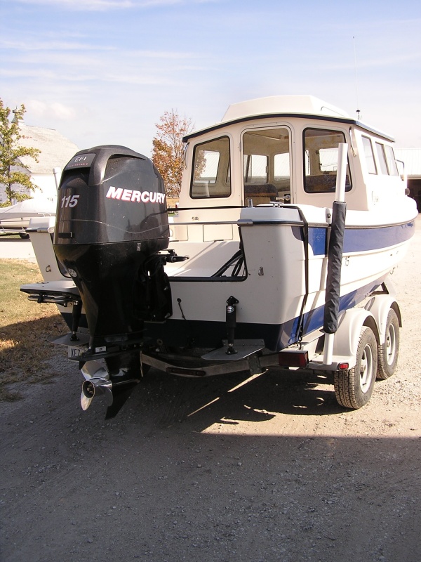

Ressurecting this thread as I need help mounting a new kicker. Swee Pea looks to have the best setup I've seen so far looking through some of the past forums regarding this. Here's the deal. My main is a Merc 115 hp EFI 4-Stroke. I just bought a Tohatsu 6hp, 20" shaft. I have a swim step on the port side, and I have Lenco trim tabs that are 12" x 12". I just received a Mini Jacker I ordered, but I don't think it's going to work. First off, I need to raise it higher than I'd like to get it over the trim tab piston. Then it doesn't really provide the set back I need to get my kicker behind the tab. This is what the back of my boat looks like:
Any suggestions? Photos would be great. Thanks. Colby

How about some sort of spacer between the mini jack plate and your transom. A 6hp Tohatsu is not that heavy of a motor. Even if it is just an inch maybe that will buy you enough clearance. You can notch out the bottom of the jack plate to clear the tab piston

I just mounted trim tabs and a Mini-Jacker, so I had to figure out a similar set up. But... I can't quite visualize why the Mini Jacker won't go "high enough" to clear your trim tab actuator (piston). On mine the actuator top is "inside of" the Mini Jacker, but the "insideness" wouldn't change if I mounted the MJ higher or lower (I did have to make sure I had it set up athwartships to clear properly, but not height-wise). Is yours hitting at the bottom of the inverted U of the Mini Jacker? It does look like the Lenco actuator mounts fairly high on the transom, so maybe by the time it gets to the bottom of the Mini Jacker it's angled out too far on its way to the trim plane?
On mine the setback was close, but does clear the tab without any problem. I had asked a pro if "a miss was as good as a mile" and apparently it is (since the tabs cannot move aft).

If I remove the wood pad from the mini jacker to get more clearance on the trim tab piston (since I can always trim the bottom of that pad), the transom side of the jacker still needs to sit about an inch and a half to two inches above the top of the transom, which really puts the kicker too high. As for a spacer, that might possibly work, but that's just more material I need to add then. If the Fulton unit would fit like it did on Swee Pee, I may need to go that route. I'll see if later today I can get a few more photos with the mini jacker held in place for a better visual of the problem.
