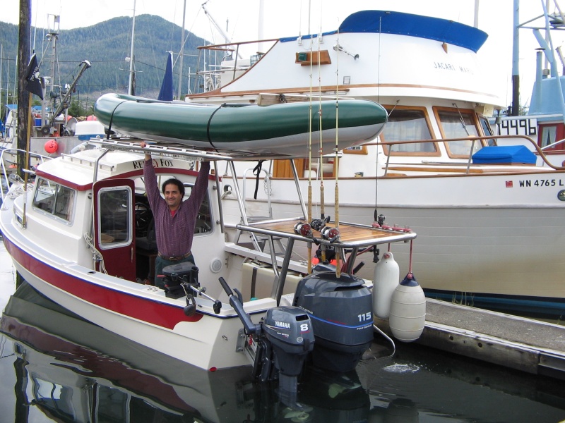

I got to drive Greg's Red Fox this past summer.
His flat bottom Classic 22 is loaded very heavy, and the 115 pushes the boat with authority!
The boat is so heavy that cutting wakes is no problem. The boat carves tight turns at high speed without any skipping or blowing out.
My opinion:
If you operate your 22 heavy (5,000lbs or more), a 115 is a good choice.
If you operate light with just your lunch and jacket, then 115 hp my be too much.
Notice how far down the stern of the Red Fox is.
Larry H
