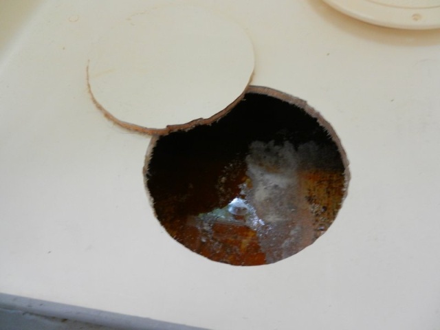

I started with a small inspection hatch at the center of the forward bilge. I cut out a circle the right size for a hatch:

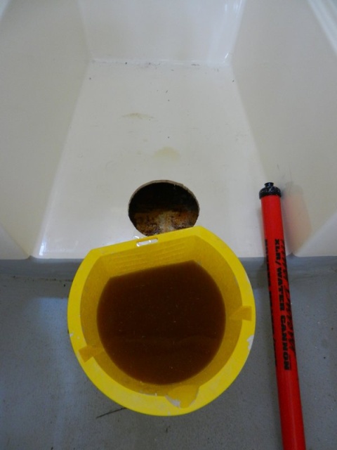

There was about 2 gallons of NASTY water in there:

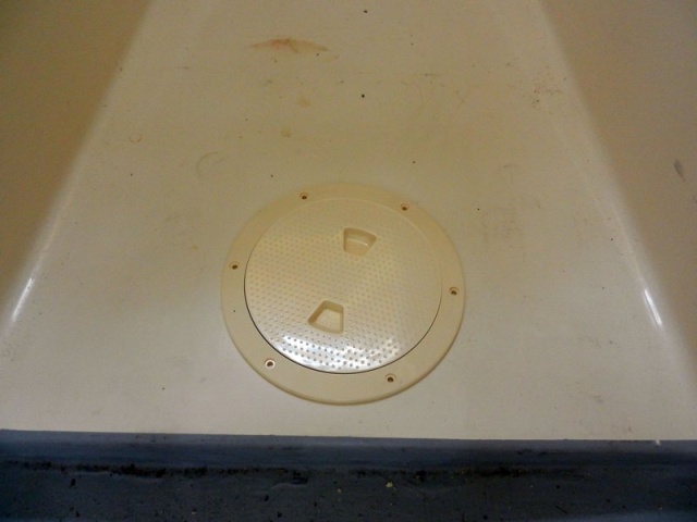

After cleaning it all out, installed the inspection hatch:
No need to clean up - there was more to do!

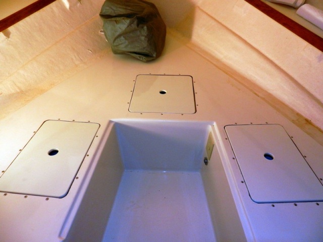

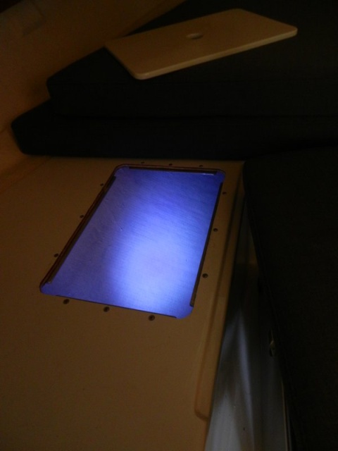

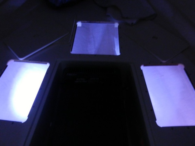

Next I cut 3 access holes in under the cushions. For those that are interested, my boat (2007) had no foam or anything underneath - just air. This is actually the "after" photo - I didn't take an in-process photo as I cut them Crook
I epoxied the edges of the edges of the exposed wood after cutting.

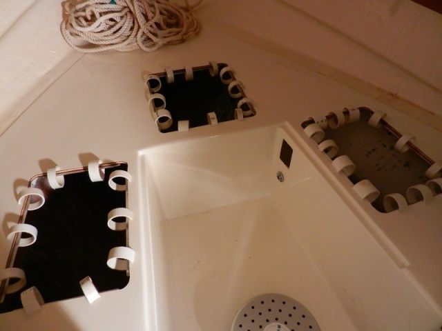

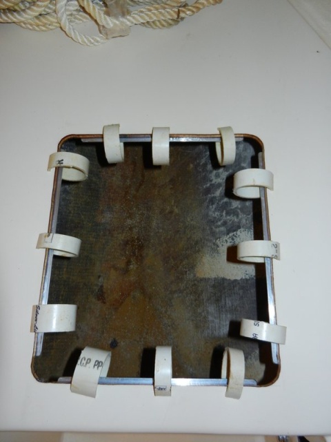

After cutting the holes, I scuffed up the fiberglass edges underneath and also some aluminum strips that I rounded the coners on. And epoxied them in to support some lids (screws came later):
PVC tube sections make GREAT clamps. You can adjust the strength by how wide you cut each slice of the tube -- skinny ones for light pressure, fat ones for strong. I make use of a huge bucket of these all the time for various projects:

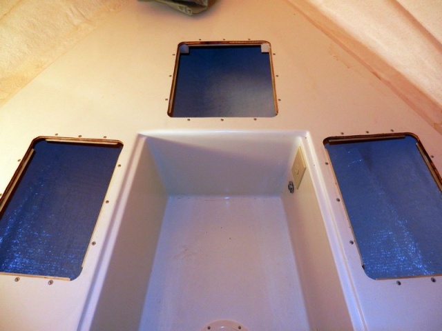

I used 1/2" plywood for the lids. I cut and rounded over a hole in the middle for removing, and then painted with Brightsides ("Hatteras Off-White is a VERY close color match to the interior gelcoat, BTW). I drilled and installed some flush-head screws and nuts into the epoxied aluminum strips also.

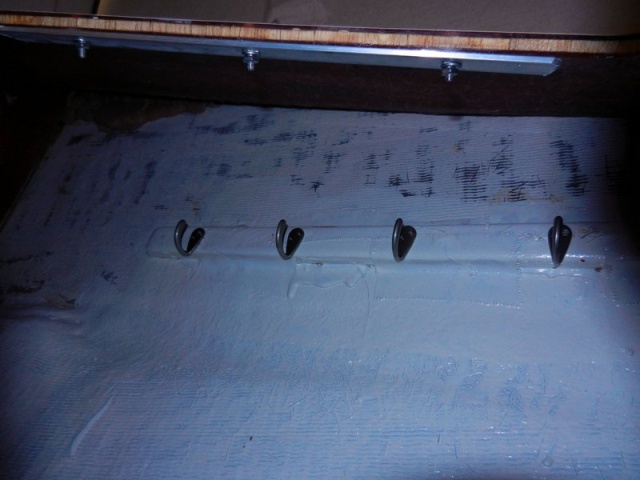

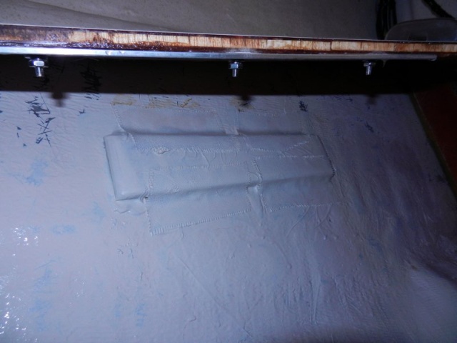

While I had my head down in there, I glassed and painted a couple of mounting cleats to the hull sides:
Then I mounted some hooks on them to hang stuff up out of the way of the storage junk down below. I have a row of hooks on each side for spare dock lines, bucket, etc.

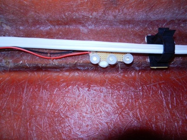

Also "while I was in there", I mounted two home made LED lights to the aft bulkhead underneath:
They help illuminate all the junk down in there when it is dark:

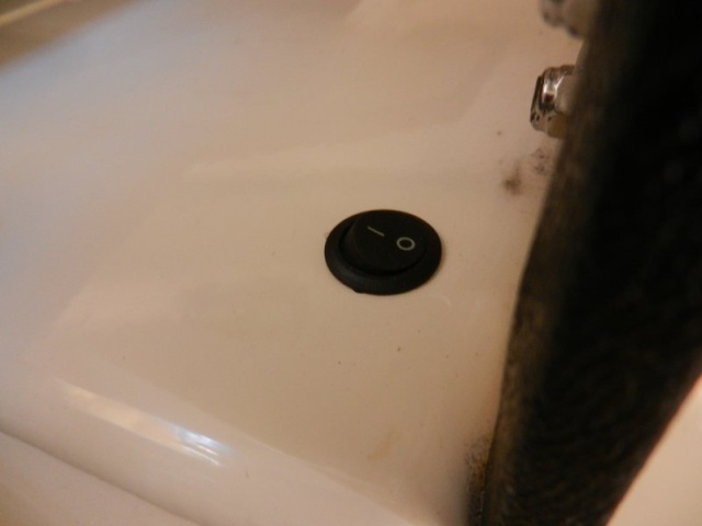

I put a flush-mount switch for the lights right at the corner under the cushion (where there is no pressure to accidentally turn on):
It was all really easy to wire up being all locally right there at the helm power location.

What did you use to cut the circle for the inspection plate, and how far down is the hull? Kind of curious what I might find in there as well. I put a bomar in the forward area and it is full of foam, really nasty foam. I like your hatches much better than my bomar. After doing one I decided not to do another.
lloyds,
I used a dremel tool and spiral bit (well, several of them!) to cut the circle out after drawing with pencil where to cut.
The hull is somewhere between 4-6 inches below this level, if I remember correctly.

That's some very impressive work you've done there. A question... Is there no flotation ( foam) in your boat at all?
Posts: 3563
PostPosted: Wed Dec 10, 2014 1:48 pm    Post subject: Reply with quote
My '08 CD22 had the factory installed hatches in the berth area. There was no foam.
One thing I noticed was even with the hatches these areas are so air tight that when I got the boat in '12 the original paint inside was still tacky and had that fresh paint smell. Stuff the PO put in the bins ended up with paint marks on them.

Pat, our 2007 had no foam either. Like the idea of the LED lights but since electrical is not my strong suit, I'll KISS it w/ a flashlight.

My question: Do the plywood hatch covers "rattle" when the boat is underway? There appears to be no fasteners holding them in place. Perhaps simple gravity and the berth mattress lying on top of the covers is adequate. I REALLY like the simplicity of the plywood vs factory-made covers.
Your other mods are very nice too.
Keep on Modifying!
david
PostPosted: Wed Dec 10, 2014 3:29 pm    Post subject: Reply with quote
I can't speak to Ray's specific covers, but I've had many boats with similar style access in the settees or berth flats (albeit with wooden support cleats) and they have never made any noise (and if anything on a sailboat can make noise while you are off watch trying to sleep... it WILL). This is a common way to make locker tops in sailboats, btw.

I was wondering about the water you uncovered. Any further insights as to how or why the water got in there? There's the anchor locker drain theory and the long screws securing the brass keel strip and penetrating the hull theory.
