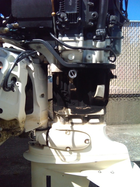

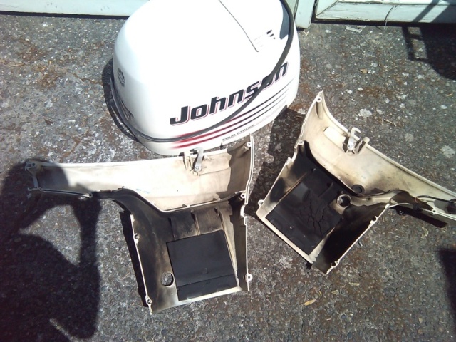

WOW! What's will all the black soot on the lower portion of the engine housing? Also notice the heat damage on the port-side cover...that crackley-looking foam insulation? Weird, eh?

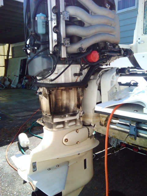

Starboard side of the engine midsection has some soot, but it's not all the bad. In defense of Jacobsen's, who opened this up most recently and didn't notice anything unusual, this is the side you normally work on.

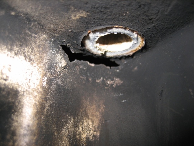

But check out the port side...wow! That can't be good. I'm going to guess that the problem is on this side. Let's go in for a closer look and see if we can spot anything obvious.
BINGO! Corrosion resulting in an internal exhaust leak. Result: Soot and "rattling" engine noise as RPMs increase. Also some heat damage to foam, rubber, and even the fiberglass engine housing.

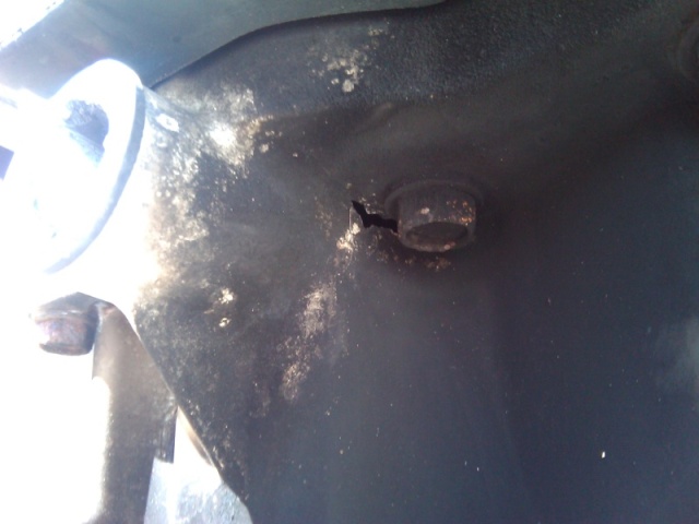

Confirmed by running the engine with the garden hose and the "ears". Water (and, therefore, exhaust) leaks out of this hole.
Decided that maybe I could patch it with some JB Weld. I can't hardly ruin a piece that already needs replacing, after all! Very low risk, I'm thinking.
First step...remove that bolt. It's in the way. Bolt comes out without incident. Now...what have we got here?
Ooh, bad. I doubt I can JB Weld this without leaving some goop that will probably prevent the bolt from seating properly. Might still be worth a try, but I should probably count on failure, and make plans to replace the oil pan casting.
And another thought occurred to me: If the corrosion is this bad in just this one spot, how bad is it elsewhere? I'm not too concerned about it breaking through to the outside, like it did this time, but if it corrodes through on the INSIDE (the actual "oil pan" part of the Oil Pan casting), I could end up mixing oil and exhaust/seawater, which sort of seems like the recipe for a truly catastrophic failure.
So I'm thinking...just replace the part. It's not as expensive at the Engine Holder. About $400 instead of about $700. And the labor should be less, as well; the illustrations suggest that a LOT fewer bits and pieces need to be connected to the Oil Pan than with the Engine Holder.
