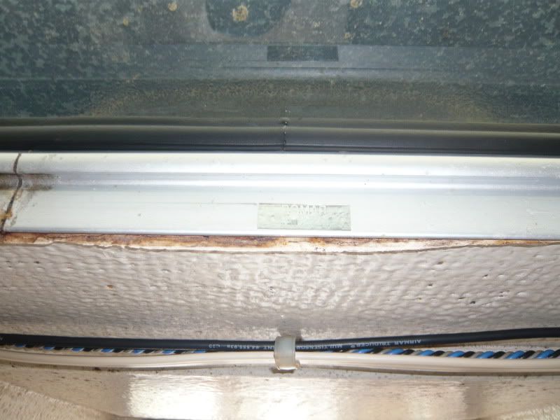

so spent about 4 hours pressure washing off 14 years of grime today on the boat. When I was done I went inside and seen that there was a few water spots on the cuddy cusions. wich confirmed what I thought and that was I had a leaking hatch door. I have checked it before after a rain and not seen any full penetration.
It seems to be worse on one side and the others don't seem so bad. so my question is has anyone dealt with a leak like this and what would be the best way to go about fixing it? I took one picture of the worse spot attached below. thanks for any help. I am hoping someone has done one of those step by step write ups i have seen on other fixes

Do a search for "leaky hatch". I had the same problem. I found that after slicing the previous bonding material with a sharp utility knife, when I removed the hatch trim, I noticed the factory did not apply enough sealant. I removed all of the wet core material and filled with epoxy filler. This time I put a bunch of 5200 to make sure no more leaks.

I also had a leaking front hatch. When I removed the hatch I found the core was soaked. I dug out all the wet balsa, let it dry out really well, and filled with thickened epoxy. Sealed the hatch real well when I reinstalled.

Many times the cutout is not exact, and this necessitates more caulking that is desirable (the fit should be snug around the frame). Two C Dories I had to actually add a little glass, after I removed core and filled with epoxy.
I would suggest 3M 4000, It is about the same as 4200, but not affected by UV light.
Removed the hatch and all caulking--then remove any wet core, and fill with thickened epoxy, then rebed with the 4000.
