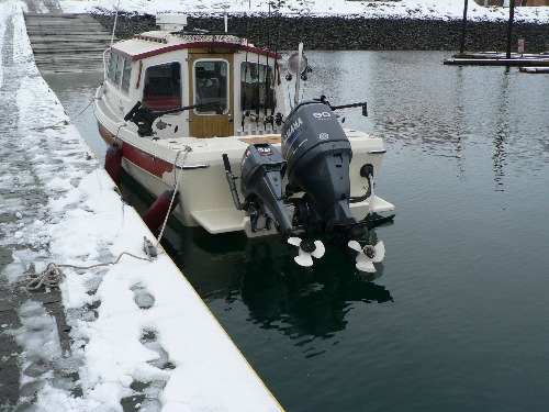

Another way to gain length in the cockpit AND keep that great cabin is to do the motor bracket mod. This could eliminate most of the splash well giving another foot and a half of open cockpit. I am in the planing stage currently but will be taking this on shortly.
Mike
For those of you unfamiliar with this approach, you may want to consider what has already been done along these lines.
Billy's hull extension was the first along these lines for a C-Dory 22.
Billy's finished project. Project photos start HERE. And the discussion thread is HERE.
Next up: Alasgun Mikea doing somewhat the same on a CD-25!

From what we have seen on the CD 25 and its transom, there would need to be some modifications, but I feel that it would lend well to a Armstrong Bracket. In the models where the plywood does not go across the entire transom, you would have to keep some re-enforcement in the well area, but I could invision cutting back the well, and putting something similar to what is on the Tom Cat 255, but narrower This could give you another 2 feet in the cockpit. We considered this on our CD 25, and have not entirely dropped this idea.

I had admired that work, but does it lengthen the cockpit, or just unclutter it? Sounds like the torque on the transom is well handled. Cool (but major) project.
Soon to join C-Dory owners
Posts: 21380
PostPosted: Sun Jul 15, 2007 6:31 pm    Post subject: Reply with quote
What we proposed would lengthen the cockpit. In the 2003-2005 CD 25, the cockpit floor extends to the transom. You would only have about a 6" ledge at the top of the transom, even with the gunnels, which was left after revision. 6" is often the "thickness" of many sportfishers aft railings, transoms. This would not affect the "Fishability"--But you do have the armstrong bracket aft. In the Tom Cat I see the bracket as a real plus.
