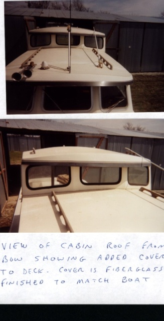

Saw a couple a few years ago in Homer that had a design something like what you are going to tackle. It was a 25' and they had the top made out of fiberglass with storage built in over the cabin. The top was made at the c-dory factory in the 80's.
If you can incorporate into your design the storage always sticks out in my mind. Great idea!
PostPosted: Tue Feb 13, 2007 2:17 am    Post subject: Reply with quote

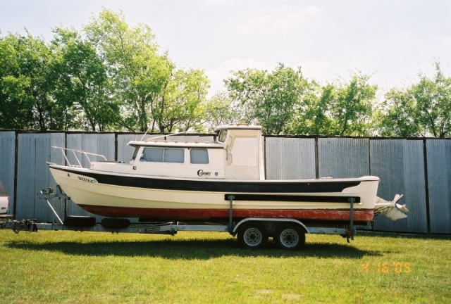

Somebody who was contemplating adding a partial cockpit cover to his own boat had a photo of that 25 here about 2-3 years ago! Might be in one of our albums.
FOUND IT!
1982 C-Dory 26 with factory supplied roof extension (from Gary Johnson's Album)
Forward view
Here's a LINK to the Hardtop Extension discussion about this and other boats.
Joe.
