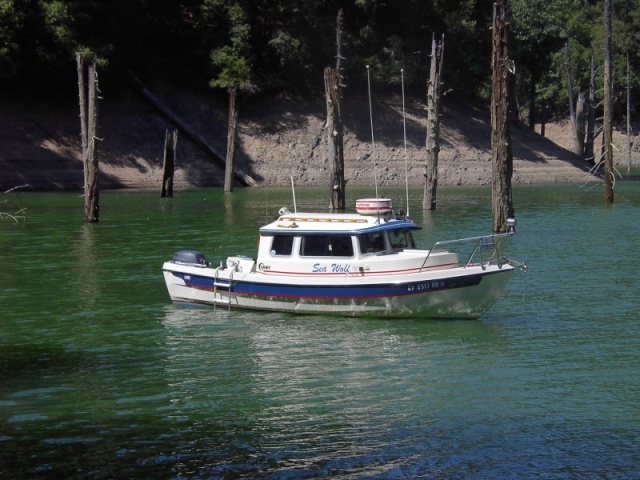

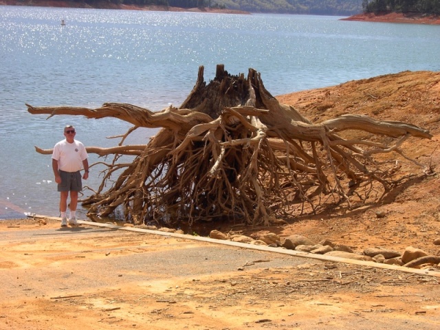

Here's one of those "Anchor Traps" found underwater at Lake Shasta and a second shot of a cove on the Pit River Arm that was never cleared of trees in order to privide cover for the bass population:
Drop 'er down and spin the wheel 'o fortune!
