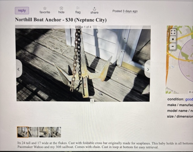

For Dr. Bob.
Posts: 21375
PostPosted: Thu Mar 13, 2025 9:43 pm    Post subject: Reply with quote
I love the original North hill anchors. I have one similar to that on my caracal Cat. I have carried some of the PBY Sea Plane anchors on mid sized boats, incuding the cal 46. The sea plane were folding and Stainless Steel, they were lighter than the forged steel anchors. $30 for one is a good price. But they are hard to use on an anchor roller.

PostPosted: Fri Mar 21, 2025 4:38 pm    Post subject: Reply with quote
Seeing this is like looking back in time. Like watching an old WWII movie.
