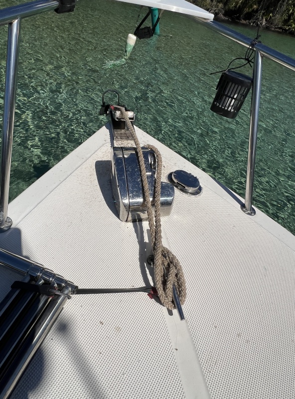

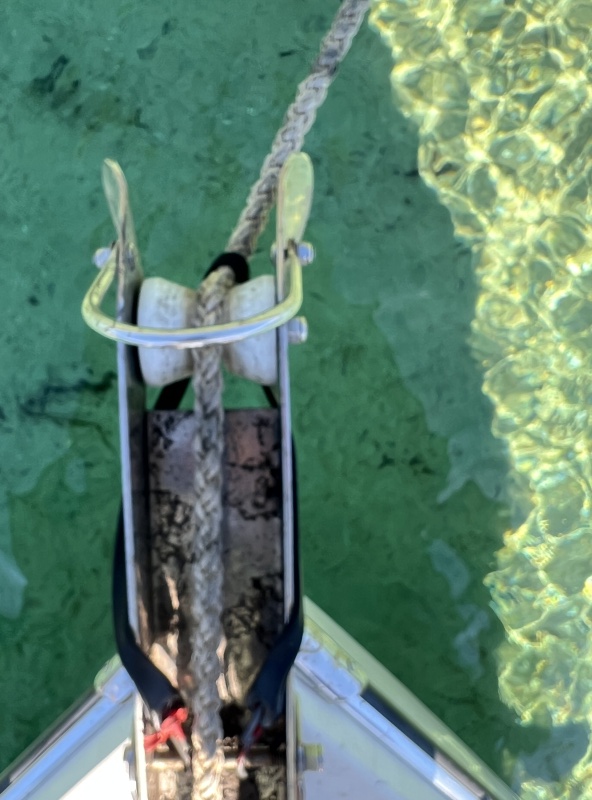

You never want to just leave the windlass to hold the anchored boat. Unless it's in calm water for a lunch stop. I have 300' of 8 plait rode and 20' of 1/4" chain. I had an 13 lb Delta anchor, but won the 22 lb Delta in the auction. Very Happy I also have rode markers every 30'. (Little vinyl tapes with the distance marked on them that you can buy at most marine stores.) Once my anchor is set, I will use the bow cleat behind the windless to wrap the rode around a few times to tie off. Then I have a rubber bungee I put around the anchor rode just in front of the bow roller, and hook both ends to the pivoting pin in the bow roller. This keeps the anchor rode from going back and forth on the roller during any sailing of the boat, to keep it quiet.

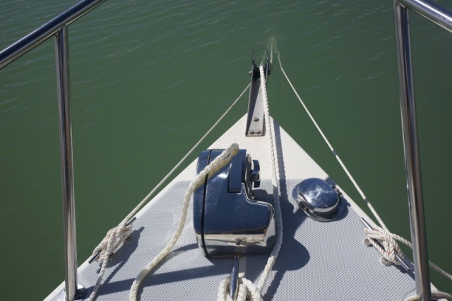

It is well advised to not allow the windlass to take the full load of anchor. If the windless slips (just clutches which hold The load of the Lamar and similar windlasses. Some windless have pawls, to hold the chain/rope gypsy. Also if the anchor rode is well out it will be the nylon anchor line which is jammed into the gypsy. Not good for wear on the line either.
I use the main forward cleat or a bridle--as illustrated below.
The light lines (5/16") take all of the load, the center cleat, next to windlass has slack in it. The same is done when using all chain, but even with 50 feet of chain, I rarely anchor by chain only (to get the 7 : 1 scope in the anchor rode.
I don't like the chain stopper or a chain tensioner on the deck in a C Dory. Some boats they do serve a purpose. I just tie a light line between the anchor and foredeck cleat to be sure that the anchor does not self launch--be it on the road or in the water.
Incidentally there is the deck pipe with cover, shown on the Starboard side of the deck. A Hawse pipe is a tube from the deck to the outside of the hull near the stem. It does not go to the anchor locker.

PostPosted: Wed Mar 12, 2025 12:08 pm    Post subject: Reply with quote
Here is a photo of my anchor setup while deployed.
And if you look closely at this one, you can see how I use a rubber bungee cord to snub up the anchor rode so it's not so noisy sliding on the front roller when sailing in the wind.

A question for Dr Bob.
On your main anchor line, I see you have a bridle set up, which to my understanding takes the load off the the main rode to the windlass. 1. Is it still necessary to tie the main anchor rode to the cleat behind the windlass since the bridle is carrying the load? 2. Does the bridle line stop the fishtailing when at anchor?
I'm still trying to weigh out the necessity of tying the anchor rode to the cleat behind the windlass. I understand it is preventative maintenance so to speak but in my experience of anchoring (which is slight compared to your ventures) I have yet to have a failure of the windlass clutches. But I have had times when I really didn't want to venture out to the bow to unleash my anchor line form the cleat. I would have felt much safer just staying inside the cabin to pull the anchor. In which case I would have neither the bridle or securing to the cleat.

Posts: 21354
PostPosted: Thu Mar 13, 2025 12:20 pm    Post subject: Reply with quote
The cleats are install thru the deck with backing fender washers or back up aluminum plate. Over drill and epoxy seal the holes.
I like to have the cleat behind the windlass--just to the side as I show is fine--if you get too far to the side there is risk of chafe on the anchor weldment. Do not put a "bow Sprit" on the C Dory. It is not necessary; You can find or have built anchor rollers which will do what you want. I even had one which could be taken off easily and mounted in reverse on the deck, with a 3/8" SS plate which had threads cut into it for the flat head 3/8" bolts (Allen head for tightening). On a bigger boat--you could go slightly smaller on the plate.
