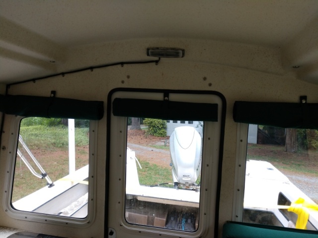

The majority of C Dory owners just cut panels of sunbrella or have them made, with snaps on 4 corners, and the male mate on the window frame.
a
Our last 25 had curtains laminated with light off white vinyl material on the outside, so the light transmission was diminished and the pattern does not fade.
There is a wood valance on the longer side windows, but just snap on for the windshield, and back door. The valance has 1/8" bungee cords to hold them in place when rolled up.
rolled up above
Curtain down, and Reflectix between the window and curtain
I also cut Refectix (mylar silver coated bubble insulating material), to reduce the heat transfer through the widows,
installed between the window glass and the curtain.
