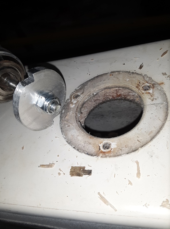

For small holes I found the best was to use an allen wrench in a drill. Usually I would cut the short end of the allen wrench a little shorter and then stick it in the hole. This worked pretty well. For the larger areas like lazarette hatches I made a little tool out of 1/4" aluminum:
Clay

Clay I will definitely be experimenting with the allen wrench idea, I have a whole coffee can of extras to work with. I like the tool you made, I have made similar for a couple of other applications and don't like using them unless absolutely necessary because they can do a lot of damage to materials, clothes and flesh if you aren't really paying attention. I need to look and see what kind of slot cutting router bits I have and maybe pick up a couple more because they should be perfect for the larger openings. Having one with a top mounted bearing and one with a bottom mounted bearing I should be able to quickly and safely prep the openings.[/img]
