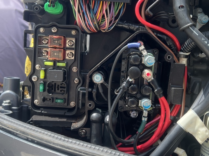

The photo above is at the front port side of my 2009 Yamaha F150 4-stroke outboard. The fuse panel and wiring terminals are behind a plastic shield. My outboard has an alternate charging system, in addition to the regular system from the alternator. Don’t ask me how it works, I don’t have a clue. The two red wires at the wiring terminal appear to go to the alternator and to the alternate charging lead. The two large red fuses in the fuse block at the left, are 50 amp fuses, and the top one appears to be for the alternate charging system.
So here’s the deal. The normal alternator appears to be putting out about 14.5 volts at the batteries, at the second or lower red fuse in the left fuse block, and at the red wire’s terminal at that wiring terminal on the right. (When the batteries are somewhat discharged, then the voltage drops to about 13.5 volts.) However, the top fuse, and the alternate charging lead at the battery is showing about 15.5 volts when the battery is connected. It drops back down to just a bit over 12 volts when I disconnect the battery. I am reading voltage from my Vectron Battery Monitor, the Digital Engine gauge and a separate VOM, with the engine at idle, and also at around 1000 rpm.
The alternate charging lead is hooked to my starting battery and unless I trip the breaker near the battery in that lead, that battery is always getting charged thru the alternate system. That would be battery 2. My house battery is battery 1. If I have the batteries isolated, ie, battery switch to battery 1, then I’m seeing that 15.5 vts on my starting battery. If I go to both, or battery 2 (thereby bringing both the regular and alternate systems into battery 2) it seems to even the voltage out back to about 14.5 volts if the batteries are charged, or 13.x when they are being charged. If I select battery 1, the house battery, then I will see the normal voltage of 14.5 on it, but battery 2 with the alternate charging system is back at about 15.5 volts.
I believe 15 + volts is probably a bit too high for my standard lead acid batteries. I spoke with a mechanic last week, and he felt it was probably a bad regulator/rectifier. Well I just replaced that today with a brand new one, and I’m getting the same readings, so thinking then that the voltage regulator/rectifier is good. But still concerned about the higher voltage output on the alternate charging side.
Does anyone have experience with Yamaha’s alternate charging system, know anything about it, or if voltage of 15.5 volts is good for my lead acid starting battery? I am leaning towards just removing the alternate charging system by leaving the CB tripped at battery 2, and using my 1,2,both battery switch for charging my start battery. Colby

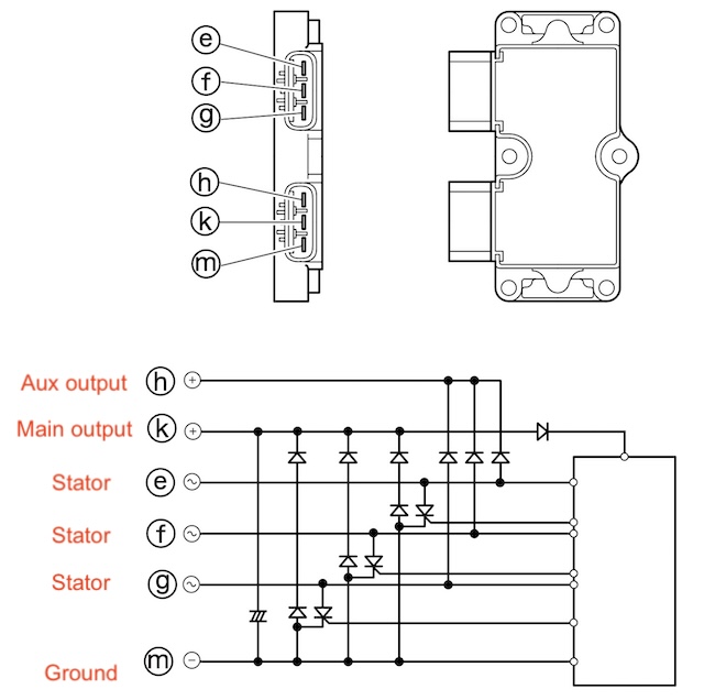

So, someone on the Hull Truth did locate a schematic for the Yamaha F150 Voltage Regulator/Rectifier:
I'll let the engineers and technicians figure it out. But since replacing my regulator/rectifier did not rectify the problem Mr. Green , I am thinking about another option. I have access to a DC to DC charger and wondering if I can just connect my alternate charging lead to the input of that, and then connect my house batteries to the output. My assumption that the charger would regulate the voltage to a more appropriate level. Oh, and I did record the voltage output of both my regular charging system and the alternate system at various engine RPMs. The short of that being, the regular system put out anywhere from 14.37 to 14.67, while the alternate lead was putting out anywhere from 14.69 to 15.16. The weird thing is the alternate system, when the battery was removed from it, would put out 13.20 vts at idle, but 12.7 at 1600 rpm... No, I didn't reverse that. Higher rpms lower voltage... Colby

You can see in the schematic above, and confirmed by schematics I found with a quick google that the source is the same for both the "alternate" and the primary charging lead - The Stator. The stator (pictured in individual phases) is driving both the alternate/auxiliary charging and the main output.
The only point of this system (and the pictured diodes) is to have two charging circuits that won't feed back into one another.
I would run both wires to one start battery, and also have both batteries tested. I may not have all the information, but it doesn't seem possible that you'd see drastically different charging voltages on two healthy flooded or agm batteries that are not currently under load.
The two outputs are literally sharing opposite sides of a 3-phase AC waveform, I don't see a way they could be performing differently unless there's a problem downstream. This is reinforced by the fact that you replaced the regulator-rectifier and there was no change.

Everything is as I described it. Weird! My concern has been that I believe 15.x volts is to high of a charging voltage. I can just leave the aux output out of the system, but I would really like to just leave my main battery switch on the start battery, and have the aux system charge my house batteries. I've given up trying to figure out why the aux lead is putting out more voltage with the battery connected, and now thinking of putting a DC to DC charger in line with that circuit to the battery. Thought process that a Victron 18 amp 12 v to 12 v dc charger would regulate the voltage and do a better job at charging my house batteries anyway. BTW, all grounds are good and all batteries are tied together as far as their negative post goes. Colby

Weird indeed. I am sure I am missing something in understanding how the system works.
You mentioned seeing the appropriate charging voltage when both outputs are tied to one battery: I see no reason not to do that. You could then fully isolate the start and house batteries with a DC-DC in between the two batteries.
