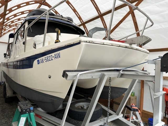

In looking at more trailer photos, I also see that my crossmember needs diagonal braces to the ladder and winch tower. It's started to bow forward from hitting it repeatedly between driving the boat on and having to slide it forward after retrieving.

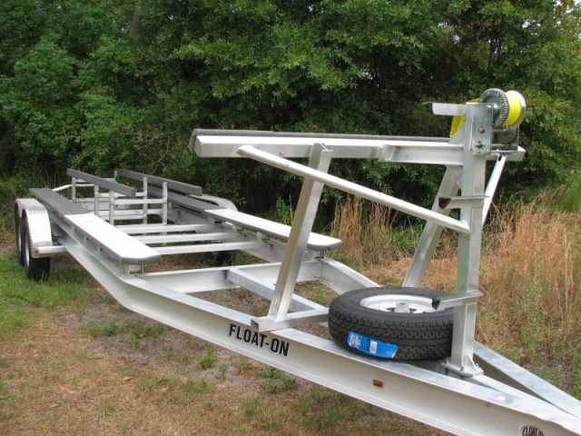

Here is a photo of the Float On trailer I had for the TC 255. The cross bar is tied to the winch post.
My Caracal cat has braces which come back from the cross bar to the trailer frame, aft. Both have the eye bolt thru the trailer under the bow eye, for tightening and preventing the bows from riding further forward.
I have often done the trick with the brakes. The geometry when the boat's stern is still floating, allows the boat's bow to rock back from the cross bar, as the hulls settle off onto the trailer bunks instead of floating.

Here's mine. Not the best photo since the bow rub rail channel is removed and draped over the trailer (topic for a different post!). My neighbor welds aluminum from time to time. Might have to see if he can weld a couple supports to the post.
Bob - you'll notice that I took your advice from a couple years ago and built a boat shed to protect the investment over the long AK winters. It's been great to have a dry place to work on the boat!
