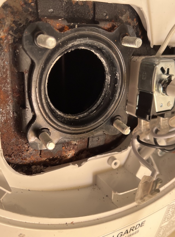

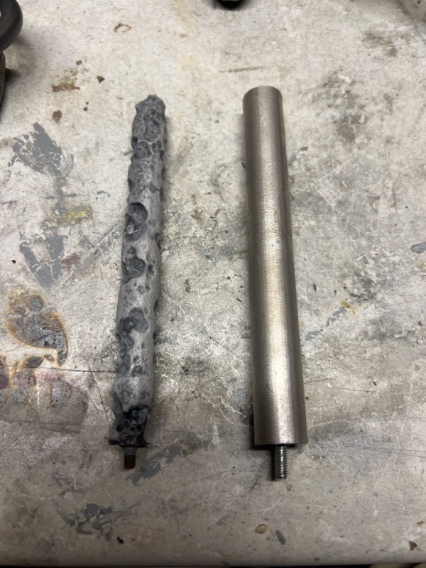

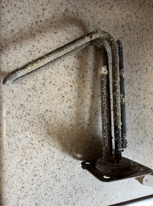

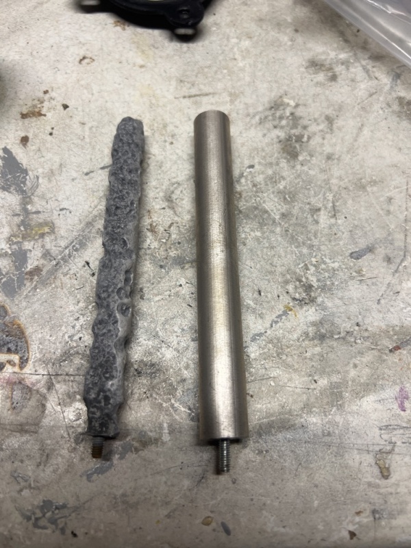

Several of us have removed the 6g water heaters and replaced them with the Bosch Tronic 3000T ES2.5, 2.5g water heater. It fits under the sink and works pretty well. I'm not really sure what the life expectancy of these little units are, but they cost around $180 currently. I have not pulled the anode out until today. I installed the water heater in June 2020, so it's now had 4 seasons of use. Water remains in the tank about 5 months out of the year. TO get to the anode, you have to remove the front face plate, and the heating element. My element was covered in corrosion and the anode was fairly pitted. I cleaned everything up and placed it back in the tank. However, I also noticed that while the inside of the tank was glass lined, the outside was metal and rusted. See photos:
A lot of corrosion on the heating element and anode, and the anode was quite pitted.
Little better view of how pitted the anode is after some cleaning
If you look close here, you can see the tank is pretty well rusted on the outside.
A new heating element and anode costs around $90. I think for the price of the tank I will just replace the entire tank, as there are some reviews of it leaking after 3 years.

Looking at the anode I would say it isn't horrible. Yes there is some expected corrosion of the anode which means it is doing it's job. The anode looks to me to be able to be replaced individually. I would research it further and see if you can just buy the anode alone without the heating element. If you find one I'd just replace it and flush the tank out, reassemble and call it good for now. I learned the hard way to replace the anode in the 5th wheel trailer. I wasn't aware that there was an anode to change out. When a neighbor commented that he noticed a drip coming from my heater I did some further investigation and pulled the anode out. It looked like a piece of corroded metal coathanger wire. Needless to say it was not protecting the tank any longer and i had to replace the entire unit. But in your case I would say it is still in very good shape. Not sure if this helped but good luck with it.

Thanks Dave, but the main reason I decided to replace the entire heater is due to the rust on the outside of the water tank and numerous reviews of leaks after several years. The cost isn’t overly expensive and I prefer not to wait until it’s leaking. Sad Colby

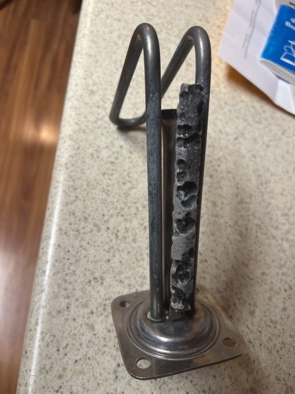

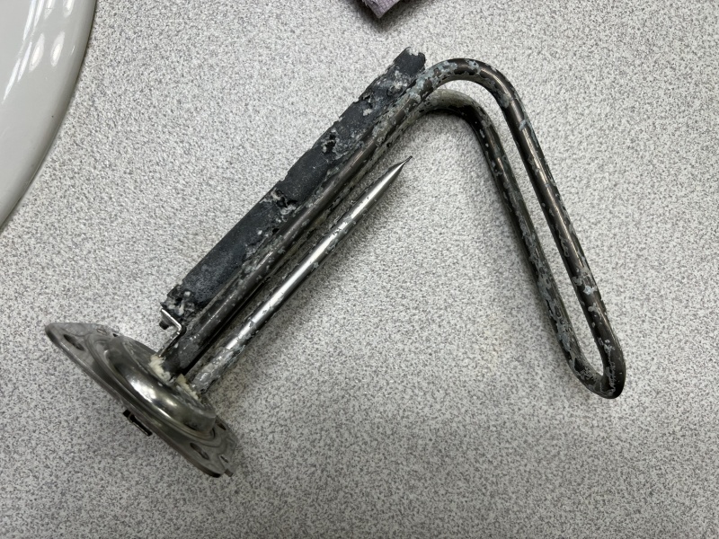

Just pulled the heating element and anode out of my new Bosch water heater. Same model as the previous one. I've only had this in use one season. And, I've been using a water softening water filter when filling my potable water tank. It appears that this brand and model water heater is eating away at the anode. Here are some photos I took of the element and anode, after soaking them in vinegar for several hours and cleaning them up:
The bottom two photos are just showing different sides of the used anode, along with a brand new anode. There was quite a bit of calcium deposit on the unit when I pulled it out of the heater. I do leave/run water in the heater during the entire boating season. (March thru October.) Colby

Looks to be that you did well to check that anode at this time. That is a lot of corrosion after just 5 or 6 months in the water. This is a wake up call for me to check my anode in the RV. Thanks for posting this. How did the tank look this time?
Posts: 4964
PostPosted: Thu Oct 31, 2024 2:56 pm    Post subject: Reply with quote
The tank itself, looked good. And the heating element looked pretty good after soaking in vinegar for several hours.
