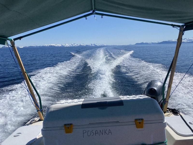

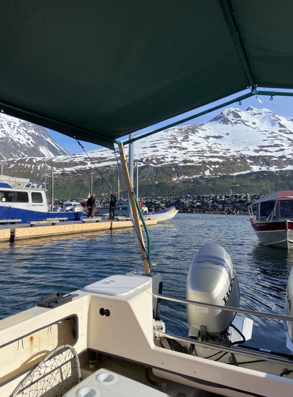

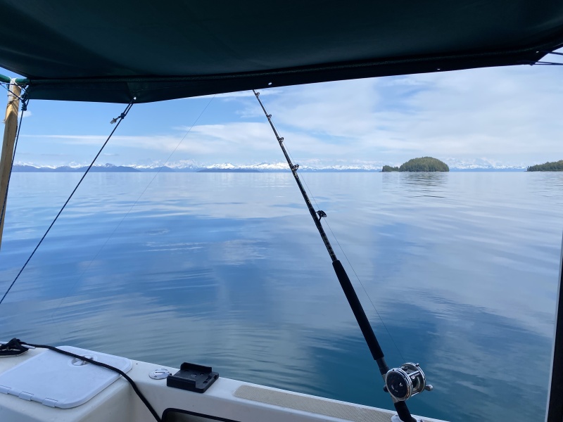

I did install the larger (medium Imtra spa40155) size and it's been working good for me. I can upload a picture later.

That's the best pictures I have now
