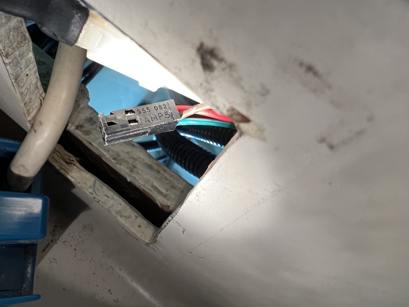

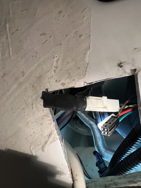

The issue I ran into was incorrect sizing on the harness data connector plug. In speaking with a Webasto tech, I learned that not all units had the original plug. In my case, the plug on the adapter harness was much larger, than the one on the wiring harness coming out of the heater. After discussing this issue with Webasto, and learning which wires attached to which wires, Red to Red, Brown to Brown, and Green to Purple, I simply cut the connector plugs off, and using some small telephone wire button splicers, working in a very small space, spliced the appropriate wires together. There are actually two plugs on the adapter harness, and three plugs on the heater harness. The data plug has three wires going into it, that match up with three wires in the adapter harness. (Voltage supply, ground and data). The other wire coming out of the heater harness, has a terminating resistor plug in it, and is for the temperature probe. It connects with the other plug in the adapter harness. The other plug on the heater harness is not used. Below is a photo of the heater wiring harness as seen through a receptacle outlet that I was having to work through.
