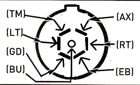

These photos may help some.
This first photo is of the inside of the 7 pin trailer plug. (You'd be looking at the back side of the plug where the wires attach.)
TM Tail Marker, AX Auxiliary (12vt), LT Left Turn, RT Right Turn, GD Ground, BU Backup, EB Electric Brakes
Also, on the newer Ford trucks with the factory tow package, some of the pins will not operate until the truck's computer recognizes an attached trailer. In which case, the pins would be unenergized while checking with a VOM but no trailer pigtail attached. Colby

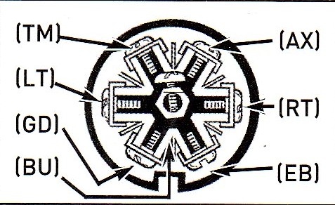

Posts: 5002
PostPosted: Wed Oct 19, 2022 8:37 pm    Post subject: Reply with quote
One more photo, this is looking directly into the plug recepticle on the truck.

checked all that. Everything works on truck and on rv except the taillights on the rv. Have another male 7 pin so going to try that. the last illustration is how my plug is configured.
