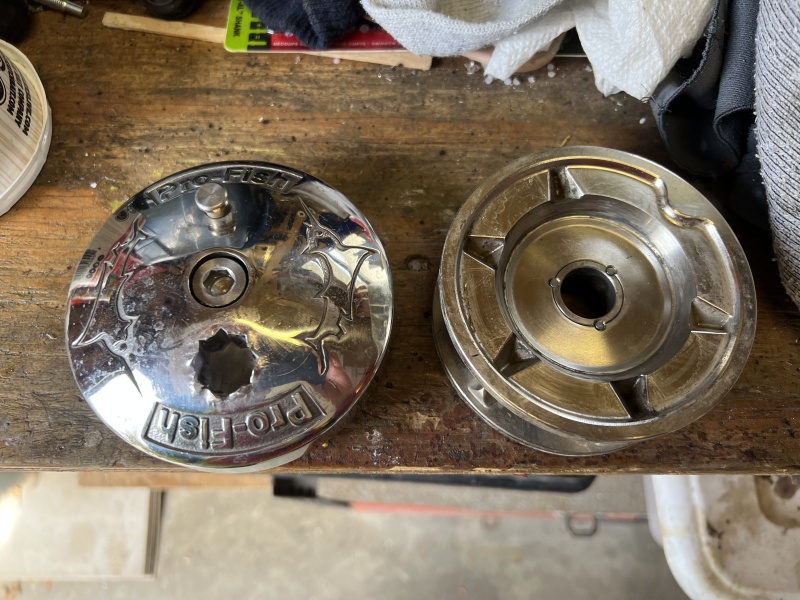

Resurrecting this thread. I have the profish 700 that I installed on C-Traveler shortly after purchasing the boat. I've never used the automatic system that lets it free fall, due to how the mechanism operates. However, I find that after several months of use, the gypsy becomes almost impossible to loosen. I have a 1/2" breaker bar that is just about stripping out the star hole that is used to manually turn the gypsy. Does anybody know if there is actually an 8 point (or perhaps it's 6 points. I need to look at it closer.) hex socket that fits better in that space? IF so, what size do I need? Colby
Posts: 21604
PostPosted: Tue Oct 04, 2022 10:29 pm    Post subject: Reply with quote
It should be an 8 point socket. Harken makes an adaptor for sailboat winches. I know that that same winch handle would work on my vertical axis windlass on my Cal 46 and the Symbol 42' motor yacht. I am not positive that the "star" fitting is the same size as the standard sailboat winch and the larger windlasss.
How often do you tear down the winch, and lube the gears and clutch plates?
Posts: 5002
PostPosted: Wed Oct 05, 2022 11:24 am    Post subject: Reply with quote
Probably not as often as I should. Last time I had it apart was last year. I don't know if I've ever greased it, but it's less than 3 years old. Seems that in normal operation it tightens itself up. The free fall operation (I don't use) works off a plunger that ratchets against a stop block. When hitting down on the switch, the plunger catches the flat edge, thus loosening the clutch to allow the free fall. When you retrieve then, the plunger continually hits against the ramp side of that block (making all kinds of noise) and the clutch tightens up from the gypsy turning. I keep the plunger in the manual mode, but apparently the gypsy clutch continues to tighten with each use when retrieving the anchor. Crying or Very sad Colby
Posts: 5002
PostPosted: Wed Oct 05, 2022 1:28 pm    Post subject: Reply with quote
Got it off. I should have just tried using the free fall plunger earlier, but wasn't sure it would work. I did have to pry the little pin out that holds the plunger in. Guess that's why the supplied Lewmar wrench has a small box end wrench with small grove that fits over that pin. Once I released the plunger and hit the switch to drop anchor, it spun the gypsy and with the plunger catching on the stop block, the capstan drive cap was loosened. I took the cap off, and removed the gypsy along with the guard and stop block. I had not greased the gypsy before, as I was not aware that it should be greased. (Thinking about old auto clutch plates where you don't want grease on them as you don't want them to slip....) I watched a youtube video that showed both sides of the gypsy getting greased. So I cleaned it up (looked like a very thin layer of grease came on it), greased it, and also greased the plunger release and access hole. I also learned that the bit I'd like to get is called a double square drive bit. However, as of yet I have not been able to locate a place that sales one in the size of 1/2".
This is a photo of the Gypsy and Drive Cap.
This is a photo that shows the plunger and pin on the side of the cap that holds the plunger in, or allows it to pop out. For anyone thinking about purchasing the ProFish, vs. the regular windlass, the ProFish free fall works by that plunger in the out position, hitting the square face of a stop block when you hit the down position on the switch, and that in turn loosens the cap and allows the gypsy to spin or free fall the anchor. When you press the up position of the switch, the plunger ratchets on the ramp side of that stop block, making one helluva racket, while the cap self tightens from the turning of the gypsy and weight of the anchor. (The plunger is in the manual position, so the winch can be powered out and in.)
