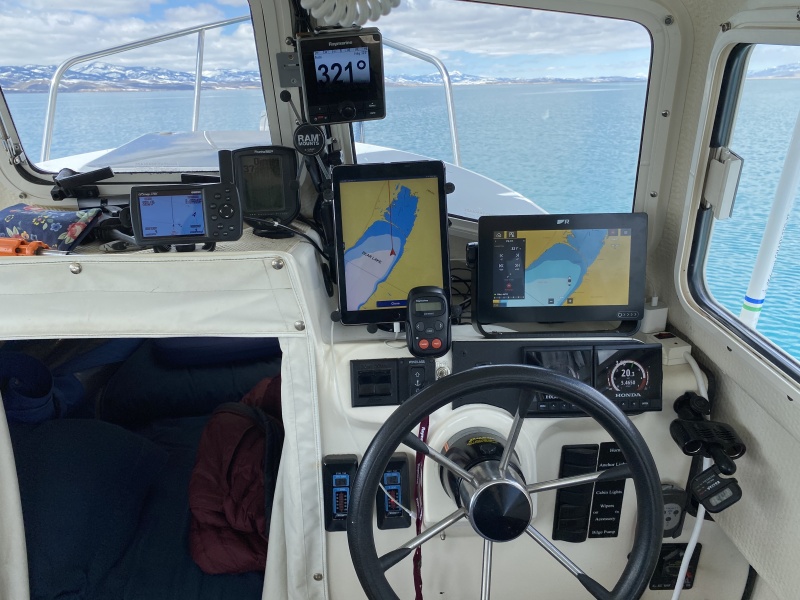

This winter I installed a new Raymarine axiom chart plotter & EV 150 auto pilot, Furumo radar & Honda nmea 2000 gauges. Today, I chose Bear Lake Idaho at 6000 feet elevation to make the first run of the season. The EV 150 autopilot works just like I was hoping it would & the engine fuel data for the Honda 60’s was impressive. 8.5 mpg on one motor at 6.1 mph. 5.5 mpg at 20.6 mph & 4.8 mpg at 24.4 mph. That by far beats the numbers on the old Honda 40’s. The 5.5 mpg at 20.6 mph was at 4000 rpm. All speeds from 14 to 22 mph was above 5 mpg. I had full fuel tanks, but other than that was running light on smooth water. It will be interesting to see how the numbers change when running our normal heavy extended cruise weights.

I really like them. Many choices & ways to view a multitude of information. I’ve just scratched the surface on how to do that, but the important stuff is easy & quick to view. I think one gauge would have given me everything I needed for the twins, but as I have both now, I’ll enjoy the slight benefit of having one for each motor & their sharing information between.

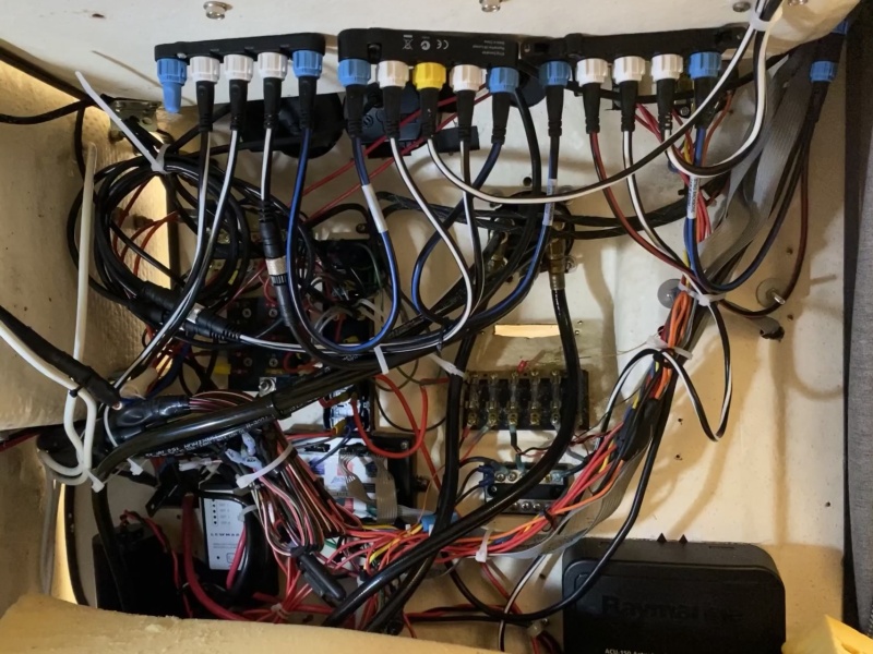

Peter & Judy, my electronics were all 1999 to 2005. A 1999 JVC radar, Raymarine S1000 auto pilot & two 2005 Garmin chart plotters. I replaced the old 2000 VHF radio when it went out in 2015 on an Alaska cruise & the handheld in 2016. I do very little fishing, so kept the 2004 Hummingbird depth finder. I also kept the smaller Garmin 276 C chart plotter. I like it’s simplicity & accuracy. I also wanted to keep the new Axiom 9 inch chart plotter, just as a chart plotter in combo with the auto pilot, though it is capable of much more, so if desired all motor data, radar, fishing sonar & other uses can be brought up on it. The new Furumo radar is separate & WiFi connected to either the iPhone or iPad with ram mounts for both. The nmea 2000/raymarine seatalk combo network interconnects the components of the auto pilot, chart plotter & data from motors & gauges. I do have remotes that work well for the auto pilot & windless.
This shows the nmea 2000/seatalk combo network. Lots of electrical stuffed into a small space, so for me anyway, only so much clean up of the rats nets possible.
