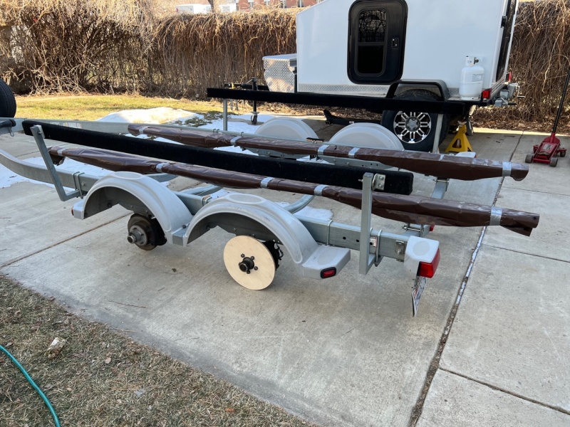

Well it’s nine ply Baltic Birch should last the 30’ I have to move it. I bet I can push it by hand now. I thought about carving 2022 AD in them didn’t think about giving them a load range.

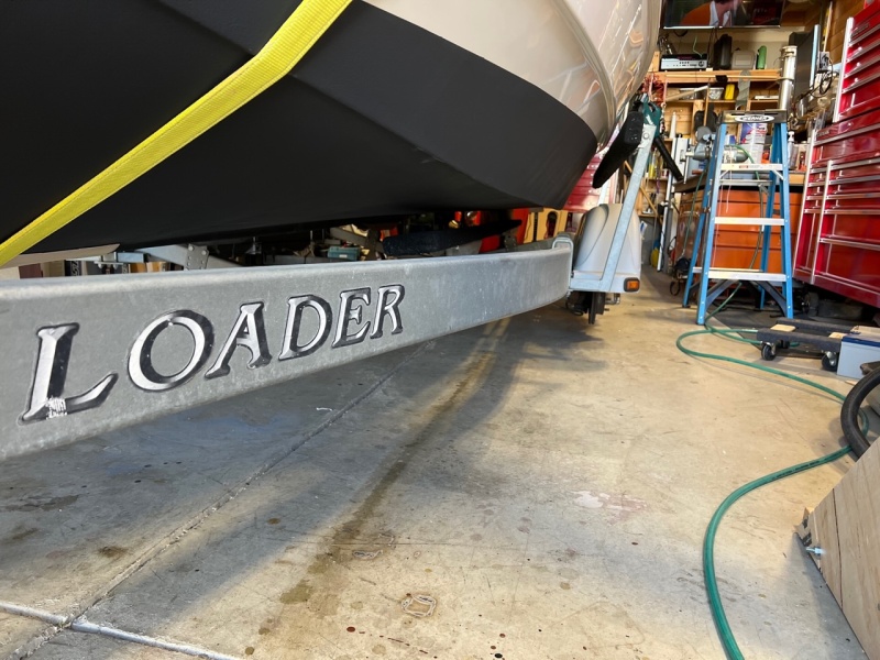

Got the load range B's mounted and does it ever sit low. Rolls nice and easy too.
Trailer back under the boat with 4 inches of clearance above the bunks.

Nicely done. I'm still impressed that only two 1/2" "wheels" didn't splinter under the strain. It'll be interesting to see how your paint holds up where the bunk boards go. Mine is already starting to wear off from loading the boat after many launches. More so where the bow runs up on the target boards. Colby

Maybe 500 lbs per wheel they didn’t even have a problem when I slid then sideways to center the trailer. What paint are you using.
PS maybe I could carry some of them for spares.
