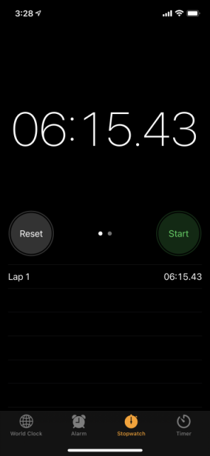

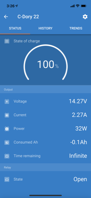

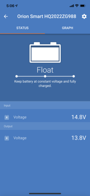

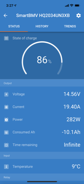

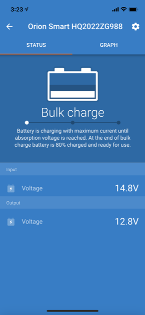

I started my test this afternoon I took my house battery down to 85 percent and ran the motor at 950 rpms to charge it back up. Next picture is the house battery status.
Next Picture is the start battery status.

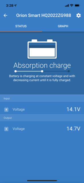

Next picture is the DC to DC charger status in Bulk mode.
It took roughly 6 minutes to switch from bulk to absorption mode.
I took temperatures of the charge coil during the test the highest reading was 130 degrees F. this was right at the end of the bulk mode. More to come later.

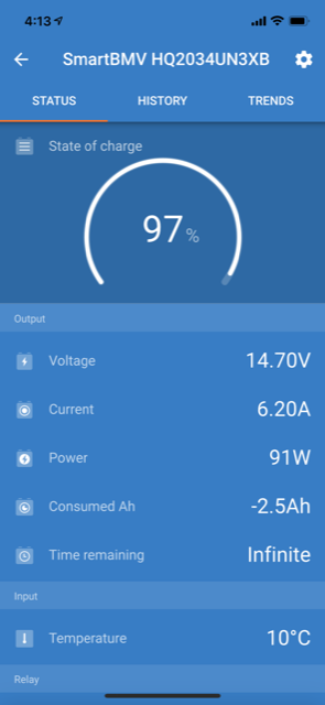

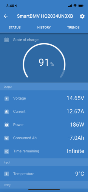

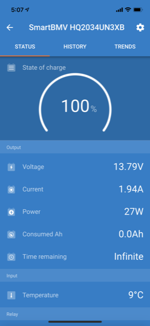

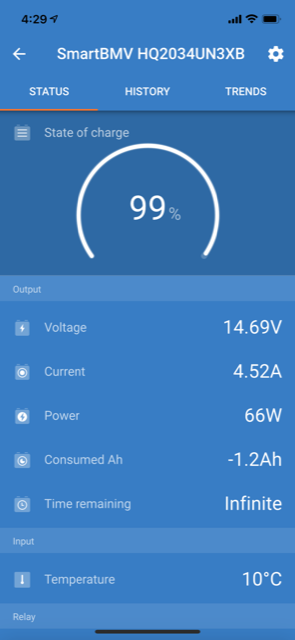

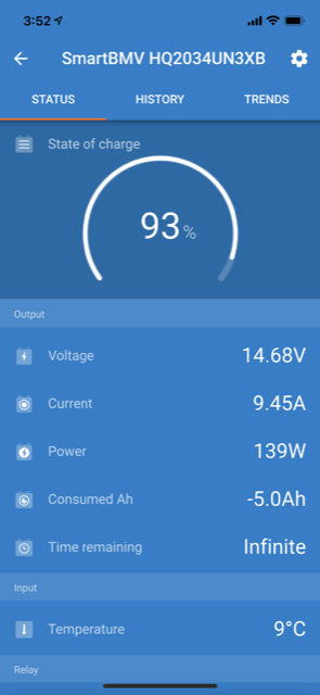

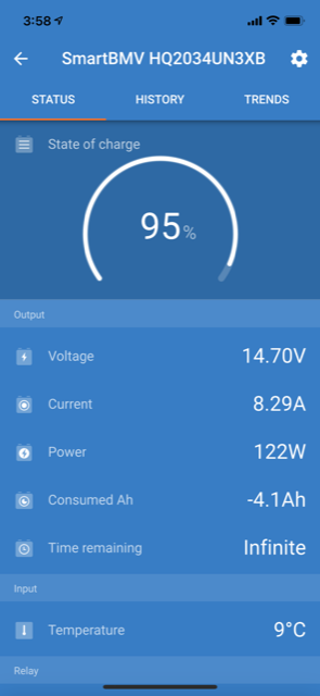

The next series of photos take you through the state of charge with the voltage and current readings.
I started the test at 3:24 pm and finished at 5:07 pm and reached a float charge at 5:06 pm.
In looking at the numbers I wouldn't spend the extra money to get the 30 amp charger and would just use the 18 amp charger instead. I am going to leave the 30 amp installed in mine.
