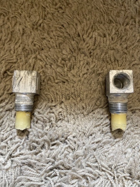

PostPosted: Tue Jul 20, 2021 7:09 pm    Post subject: fuel pick ups Reply with quote
My 2010 22 Cruiser is acting just as you describe. I installed a new primer bulb last week and it worked great-until we lost prime again half mile out. How do you remove the tank covers? Did you order replacements from Moeller or did your local guy have some? Thanks

I kept getting dual engine failures. Replaced everything from the engine to the tank. It turned out both fuel pick ups were broken off 1/2 inch from the top of both tanks. They had gotten brittle and coincidentally both broke at the same time.

PostPosted: Wed Jul 28, 2021 5:31 pm    Post subject: bent fuel vent hose...what a relief! Reply with quote
see my photos
