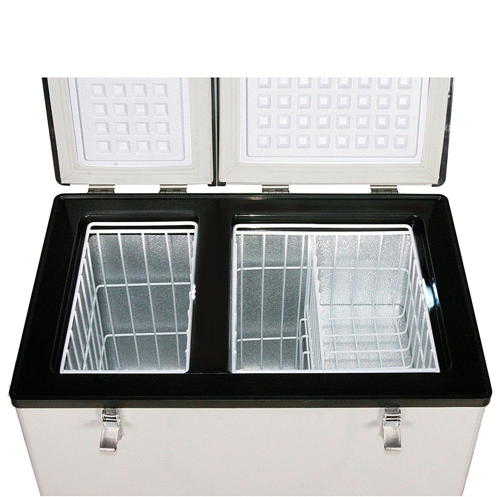

If I was doing it today I would op for one of the flush mounted top loading fridges with a separate freezer section. fridge
Tom,
I think that Isotherm system is great--but my major concern with it, is the amount of "cold" it looses when you open the drawer. It is easier to access the different shelves, than a true top loader, but because of the baskets, it may not hold as much as a true top loader also.
The Whytner 62 dual zone is about half the cost of that Isotherm, and is a true top loader. I would love to find a way to install that under one of the cabin seats--they are too big to roll out into the isle, but could be adopted to a hinged cushion top.
I have been using this in the cockpit of my 22 for the last several years, and it uses about the same amount of power (60 amp hrs day, @ 12 volts).

You know we had planned to buy a cooler and then maybe a portable ice maker but you guys about have me talked into something like that Whytner 62.
