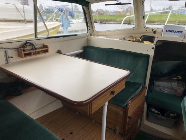

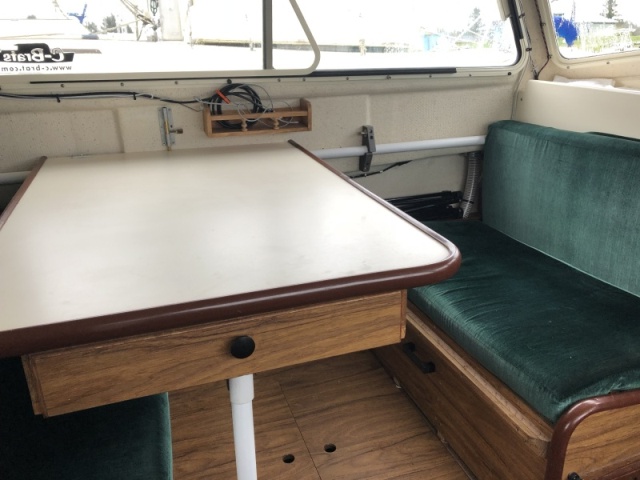

The dinette in the standard arrangement:
The table slid back:

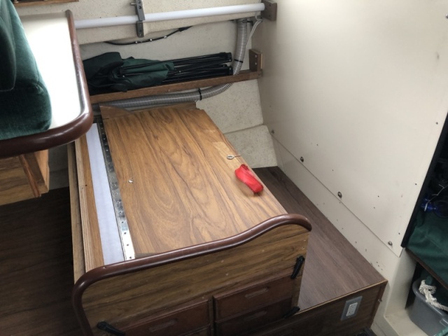

The cushions removed and the seat box slid back:

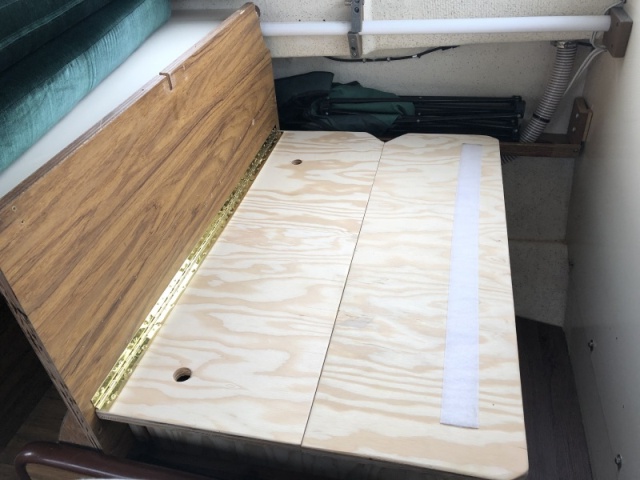

The standard seat tipped up with the new parts attached:

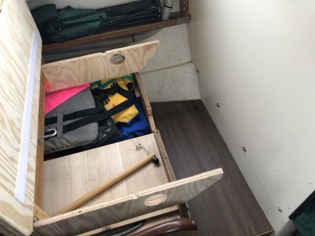

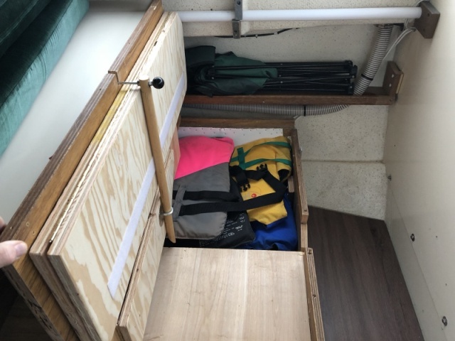

Retainer pin pulled out and the supports for the raised seat extended:
The new seat bottom unfolded and in place:

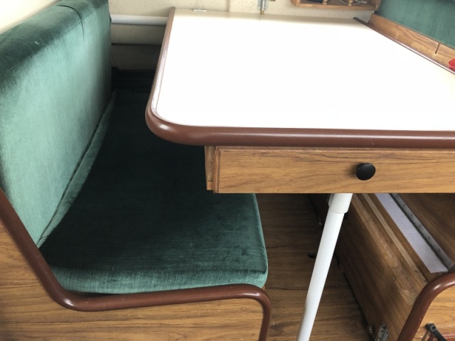

The cushions in place with the original seat bottom becoming the seat back:
The table is a little tight to the rear bench, but will work for the grandkids:
The white bar along the wall is a 1 1/4" wooden dowel with a PVC coating. It works good as a grab rail and also supports the back edge of the table and allows it to slide back and forth when the latch is released. The table leg has a peg on the bottom that drops into holes at the two locations.
The seat box has a latch to hold it in the two positions. Inside the seat box, under the life jacket storage, is another short section of the coated dowel with a bushing that guides the outboard side of the seat box. The box is heavy with the drawers and other storage in it but the combination of plastic glides underneath it and the bushing on the rod makes it slide pretty easily.
The whole process of changing it from one configuration to the other can be done in less than 30 seconds.

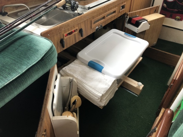

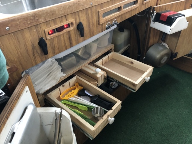

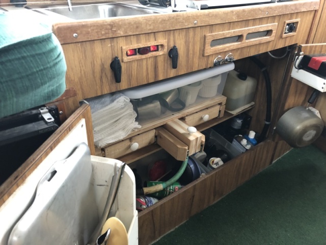

While I was busy making sawdust, I added some features under the galley counter to make it more useful as a storage spot.
The view of the mess with the cupboard doors open:
Two new little drawers:
The shelf pulled out to allow access to the stuff:
Lois agrees to never put more into the storage tub than will fit with the lid snapped on. That way we don't have to worry about being too close to the Wallas stove above it.

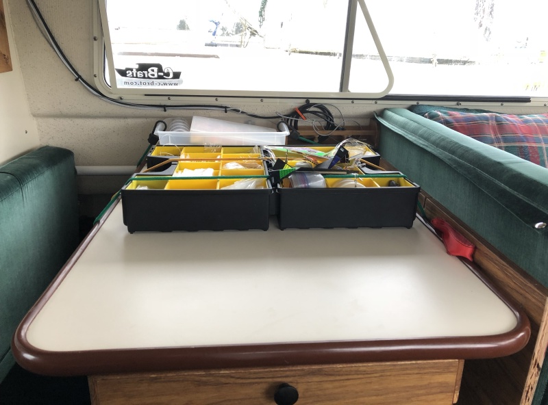

One more picture. Since we can't very well use the table for lunch, I can get away with keeping the salmon fishing gear strapped down on it!
