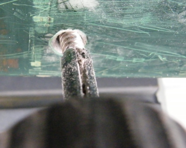

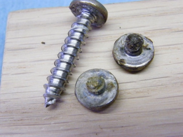

Ripple, I had the same problem with my Lenco tabs this last winter. The Lencos come with the mounting hardware as I think the Bennetts do, so I don't think that this is a C-Dory problem. You might want to call Bennett, as you still may be under their warranty. Problem is, I think they cover everything except galvanic corrosion.
It may be that the reason the corrosion is not uniform across the mounting plate is in the way the mounting plate and the tab (where the zincs are mounted) connect to each other. It is not a "solid" connection in either the Lencos or the Bennetts, especially the Bennetts. Just a guess.

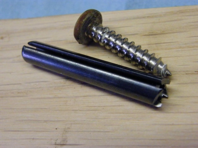

I included some pictures of the difference in the screws from the same plate, and the extractor that I used to get the broken screw out of the transom. It is called an "Unscrew-Um" and it worked very well. It "captures" the broken screw and then backs it out.

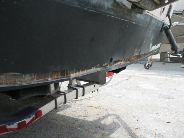

Below is a photo of how I opened the area along the plywood and bottom interface, where the trim tab of my 2003 25 was screwed. The tab area did not have rot, the area of the drain and transducer did have some rot, and was easily repaired.
