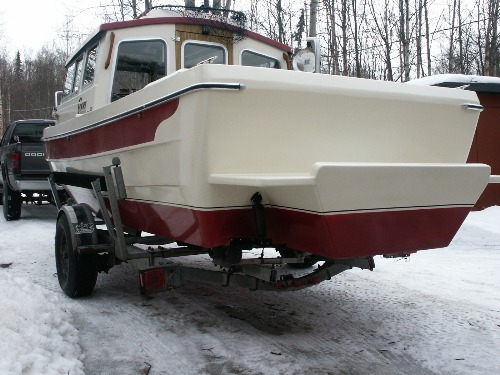

Was a 22, will be a 28 when extension and bracket are finished.

Definitely non-factory. My designs were reviewed by two naval architects and the work is being inspected and signed of on by a respected marine surveyor. My understanding when I started this project was that I needed to jump through those hoops in order to get insurance and to be comfortable eventually selling the boat. I hadn't heard that USCG had to "approve" my boat. I'm using AYBC standards and the USCG handbook for guidance as well as calling the accredited marine surveyor when there's a question. Both N.A.s said they liked what they saw. Perhaps I'm missing something, but I have endeavored to get this right. Which is part of why the project has taken so long...

I had a brief, but very enlightening, chat with Marc Grove about the engine mount dimensions on my bracket extension this afternoon that resulted in a good shake-up on my project. I spent long hours researching the best configuration for the bracket I'm building. Finally came up with my best plan and etched it in digital-granite. During our brief chat, Marc made a quick and obvious observation that completely changed my vision of how to configure the engine-mount portion of the bracket. That change will allow much more flexibility for me and anyone else that ends up with this boat.
There's nothing like a team of experienced pros to help a serious novice do it right. My project has quite a team including an N.A., a marine surveyor, a boat restoration pro, and now Mr. Grove. I've learned so much from all of these folks. The boat restoration guy and I Skype occasionally and I show him what I'm doing/considering and he has provided great practical input on how to do it right for the long-term without busting the bank or my back.

OK, Bob, but it's a bit embarassing... I was in the final throes of building the bracket core and needed to ensure that the width dimension for the mounting flange were correct; it didn't span the full width (beam) of the bracket. I'd been wracking my brain to determine the minimum distance between the main and kicker since both would be mounted on that flange. I had the Yamaha Rigging Guide open and there was no clear information on that dimension. So, I called Marc who, in a coupla minutes thought to suggest that I make the mounting flange full beam. End of story. Done.
In most of the bracket photos I've seen (Beer-Thirty, for example ) the mounting flange is less than full width, so I decided that was THE way to do it. As he said, the full width gives me all the flexibility I need with no worries about having to determine what the installer will eventually require. And it gives anyone who owns the boat after me flexibility as well.
