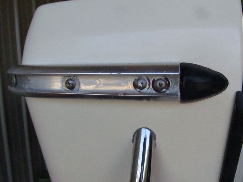

It is always interesting to see the variations between various C-Dory models/years, etc. Here is a photo from when I was re-installing my rubrail that shows how it wraps a bit further around

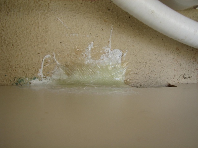

As for putting the furniture back in--I suggest some fiberglass tabs. In this case I just used some scraps of cloth I had around: After removing the screws and filling the holes in the core:

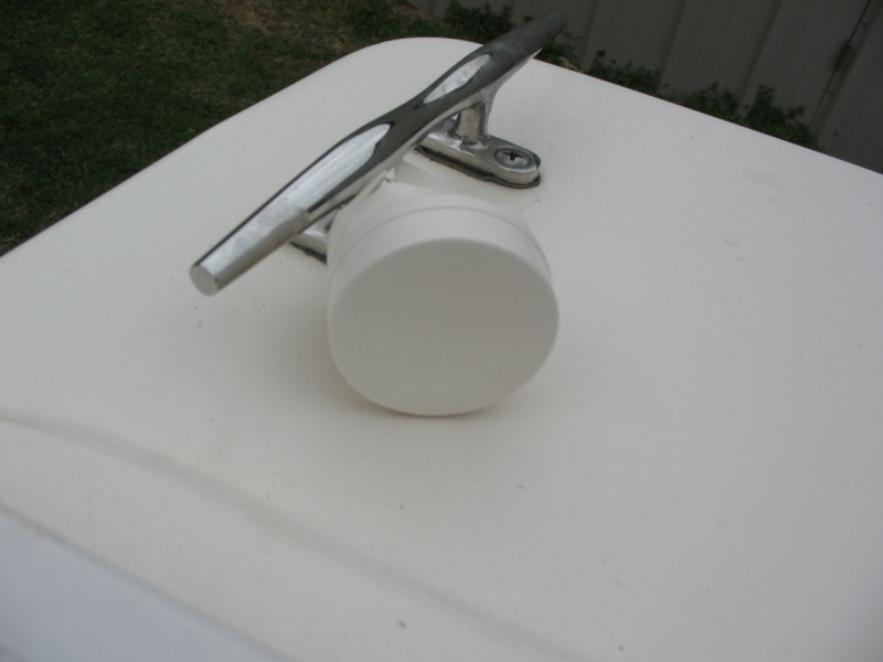

It's not that easy to get the right angle, but here is a hunk of the Gelcoat Products C-Dory white sitting on my lazarette deck (it's the puck from the bottom of my mixing cup). But any brand mixed from the correct formula should be the same.

Each of my screw holes were drilled out with a 1/2 inch drill. Then the holes were undercut, so the amount of balsa removed was about a 1 inch circle. I then put in penetrating epoxy to seal the exposed balsa. Smith brand penetrating epoxy doesn't cure with an amine blush, so my epoxy putty would bond to it.
My epoxy "putty" was the consistency of honey. I drizzled it into the holes and then returned with more putty a few times as bubbles came to the surface. I had a few areas where the volume was bigger than a 1 inch circle, and I did those in several "lifts," meaning that I would put in a 1/3 of an inch, let the putty cure and throw off some heat, and then add another layer. Reason being that if you cure too much epoxy at one time the heat generated can cause the putty to foam up.
Even though the holes were filled to the point of making a little dome of putty above the hole, the epoxy shrinks as it cures and would end up leaving a little divot or dimple. I didn't worry about that because the panel would eventually cover the holes. Plus, having some of the holes with dimples in the center made it easy to see exactly the center of the putty repair (even when painted, which I did before the reinstall) and I knew exactly where to drill my screw holes.
I had several paper cups with left over epoxy putty in them, so I drilled them for screw holding tests. I used micro-balloons instead of cabosil. MB traps more heat when curing, but my experience is that it is more forgiving when driving screws and still has sufficient screw holding ability. It is more like driving a screw into wood, where the wood can crush rather than split if the hole isn't perfect. Even still, I put a drop of penetrating epoxy on the screw just in case something went wrong (split the epoxy plug or the screw hole went outside the epoxy plug). That last part was kind of tedious, but after all that work I didn't want any possibility of exposed balsa. I secured the panel in place using the several pre-drilled screw holes for each panel. Once I was satisfied that the panel was sitting exactly in the same spot as when removed, I drilled the rest of the holes using the panel as a template. I watched and made sure that none of the swarf had any balsa in it.
I didn't use any panel-to-deck caulking for the re-install because I wanted the water that gets behind the panels to drain out. Whatever the original caulking was, it had failed (which may have allowed the rivets to work open and allow more water into the core). I just couldn't see that recaulking would do anything. It certainly hadn't done anything for the original construction technique.
