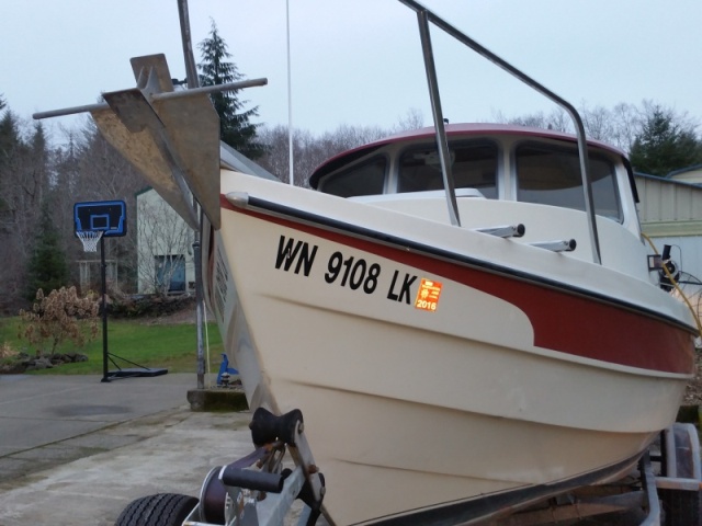

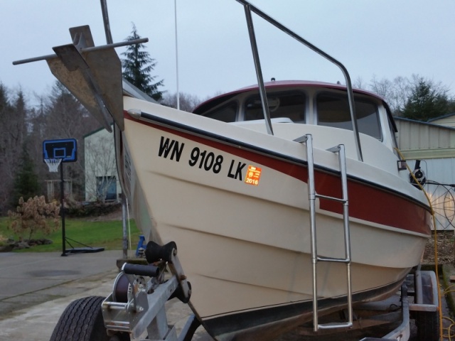

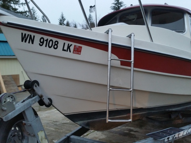

Here are the photos:
New ladder down.
The ladder makes getting in/out of the boat from shore easy without a dock!
New ladder retracted.

I'm checking out your boarding ladder and I'm considering doing the same thing. Where did you purchase it, model # etc.? From the looks of the pics, I'm guessing it's telescopic, and when retracted flips over and lays on the deck. Topside, does it fit in brackets and removable or is it permanently thru-bolted on deck? In any event, it looks great and I may do the exact thing on the Joni Lynn.
Thanks.........Paul
PostPosted: Fri Feb 05, 2016 7:12 pm    Post subject: Reply with quote
Joni-Lynn
The ladder I used was a Windline TDL-3X, and through bolts to the deck.

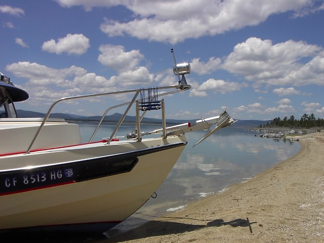

There's a discussion here:
Boarding Planks, Ladders, and Other Ideas
Note the more forward position of the ladder: Won't lay flat on the deck, but is further ashore: a trade-off.

Thanks Joni-Lynn , I got the idea from you and would have given you credit but I couldn't find your post. I had the ladder in my boat house and just mounted it a little farther aft as it folds flat on the deck and is out of sight. My 300 lbs friend, I'm sure he had it maxed out, but it worked with him.
