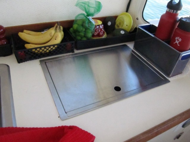

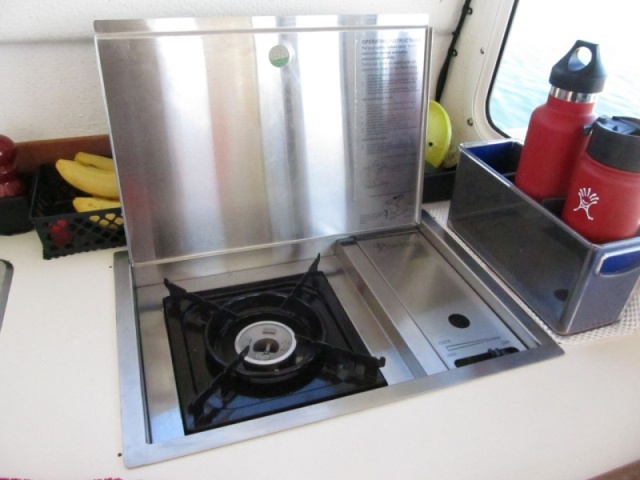

Since we've got to talking a bit more about the stoves, I thought I'd add a couple of photos of the one I recently put in. It's a Princess, like the one in the original "identify this" photo, but seems to be a less common variation.
I had originally used the one shown up top (on a friend's boat). It's not shown above, but it usually has a wooden cutting board with it that slots into the top. It was fine, but not my favorite for a couple of reasons. One is that I had to find a "home" for a loose block of wood when cooking; and two was that it did not sit flush when in cutting board mode, so the counterspace was slightly less useful (to me anyway).
When I was shopping around, I kept noticing an alternative mentioned with a flush/stainless top. This piqued my interest but I could never find a photo of it (even on their website), but rather only photos of the more usual cutting board version. I did finally manage to find a couple of photos in an ad for a used one for sale. I liked what I saw and so bought (a new) one.
The lid sits basically flush when down, then flips up when cooking. The "hinge" is simply a metal rod that pokes into two holes on the sides, so it looks to me like it would be removable, should one choose to (I think other than those two holes and the lid coming with it, it's the same as the cutting board version).
I had to add a couple of thin wooden strips to the hole left over from the Wallas 95, but that was pretty simple. You can still see a few fastener holes from it around the perimeter, but the flange of the Princess mostly covers it up. I could imagine putting in a new/different countertop surface some day.
Anyway, just figured someone might like to see the "elusive" stainless topped version.
