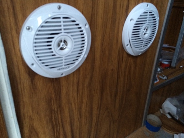

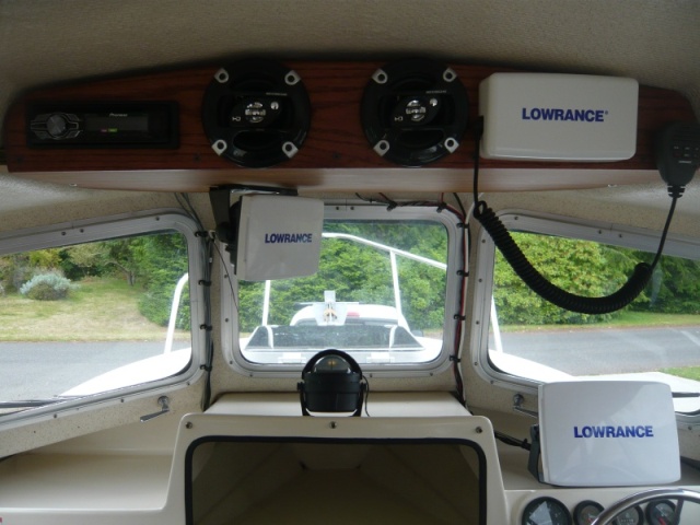

To do over I would go blue tooth. We went with a pioneer head unit and some Kenwood marine speakers under the rear dinette seat. Originally we put our speakers built into our overhead panel
These were great for the times we were up and running but you had to basically blast out the cabin to hear it out on the cockpit while fishing. also when we installed the Lowrance point one for overlay and heading sensor this winter these would not allow it to calibrate and caused too much interference so for the time being they are removed and I will have to remake the wood cover this summer sometime. While removing I noticed how much they interfered with my compass also.
Now we only have the two Kenwood speakers and they can be heard both in the cockpit and in the cabin fine. And will probably just stick to having only these two speakers for sound. They are marine grade and have good sound quality.
We almost always have the stereo on and have not had a problem with draw or batteries going dead. Again blue tooth is nice we don’t do cd's, the head unit has a USB and aux on the front and we plug our iPhone into that. The plus being if you use USB it will charge phone while it plays (we use it this way when under power). thought I would throw a few pics in as drilling speaker holes to find out they interfere or don’t let sound travel well, then have to re-drill is a pain the holes are not small.

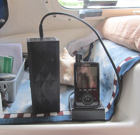

We use an original Jawbone Jambox - bluetooth from the phone or iPad, but most often with a cable to a portable (smaller than my phone) XM receiver. No holes to cut/fill, you can take it into the cockpit, or take it home with you. Easy.
