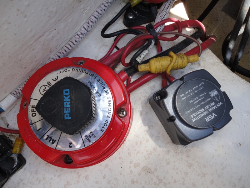

Bob, I noticed when you were getting "Thisaway" ship shape you installed a BEP VSR to you battery switch
I want to do the same for Far C'r but I am unsure of how it is wired into the switch. Does the BEP come with a wiring diagram? Is it in series with just one battery?

Basically the VSR is wired between the two input terminals of the Start and House battery. The BEP diagram often uses their on/off switch rather than the 1,2 all off switch. The Motor lead goes to the terminal in from the start battery, and "load" lead goes to the house battery battery terminal on the Perko switch.
The diagram which comes with the BEP unit is at:
http://www.bepmarine.com/media/product/pro4c27c846d96d1.pdf
