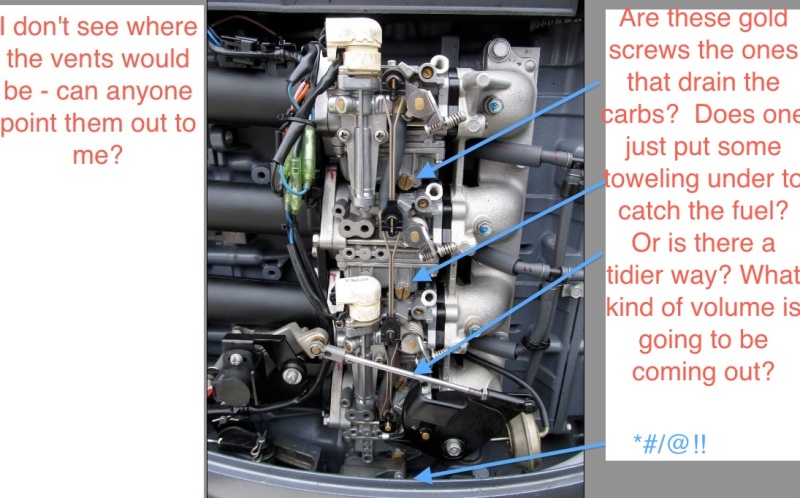

Yes those look like the drains and the bottom one looks like you would have to take the bottom cover off to get to it. Unless you have a trained mouse for the job. Rolling Eyes The vents or overflows might or might not have hoses on then depends on the motor. Like Bob says button it up take a trip there will be plenty of people around to help out if there's a problem.

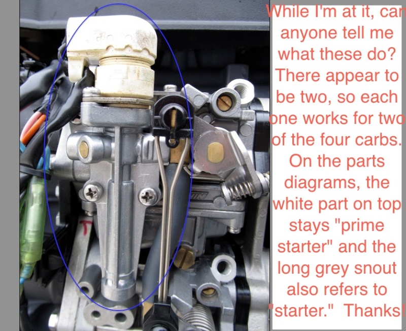

Yes...the brass plugs are the bowl drains. The hole that the blue line intersects in the second photo is the vent...if the float sticks fuel will flow out of that hole. In a bind you can remove the plug and tickle the float with a piece of wire (gently) to get it unstuck.
The two other things you asked about are the prime/start components. These enrich the fuel on a cold start...kinda like a choke...but work differently. Solenoid on top...thermal component on the bottom...have no effect on a warm start.

Sunbeam wrote:
Here are photos of the carb area on my Yamaha F80. Thanks for taking a look.
1. float bowl drain screws
2. That takes the place of THE CHOKE. Wink

The enricheners are what you have circled. When the motor is cold, these act as chokes. Also, the vents on the carbs are holes that you will not be able to see while mounted on the intake manifold, but will leak some fuel when the engine is tilted. You can also get fuel that will leak out of the carb throat, and move into the silencer. The silencer will also have some crankcase residue from the breather, which is vaporized oil and gas as the engine warms up and the breather recycles the vapors into the engine. This will make any fluids that exit the breather be a gas/oil/water vapor mixture -- dirty looking, gas smelling residue. All natural and mostly non-issues, unless it becomes extreme. You can reach the bottom carb drain fairly easily with a small box-end wrench. It only needs to be cracked open slightly to drain the carb. Do not worry about what you have seen -- you are just being extremely aware of something most others would not even notice. Smile Ron

Bob: Thanks for the time-frame reference on carb draining vs. not - it's good to have a baseline idea.
tsturm: Appreciate the confirmation on the drain screws and the "thing that takes the place of the choke."
So, if I understand it:
a) choke (which I don't have)
Restricts the air intake to richen things up.
b) "thing that takes the place of a choke"
Probably adds fuel to richen things up.
So two different means of achieving the same end, apparently. I think my Honda 8D also uses method b, whereas the old standby Honda8A uses the traditional choke. Anyway now I know what the "schnozzles" are for.
