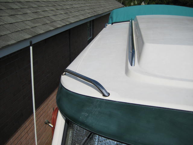

I have also put an 4 extra hand holds on the cabin roof of the 22's and 25's I have owned. I put one on each side aft on the cabin house thru the over hand of the roof lip, and forward as in the photo below. This gives you a constant handhold from the time you leave the cockpit until you can reach the bow rail. (using the inner factory rail in the middle).
You could put a longer one in the middle if you wished. I also put these type of hand rails in front of the galley (good hand rail as well as towel rack). With boats which have a forward facing front seat, I put one of these on the forward bulkhead "dash" on the port side.

I've done the two in the front like the previous picture (more or less) on my CD-22 (12 in rails). I will probably do the same thing in the back for getting from the cockpit to the side rail and back, also like in the picture.
