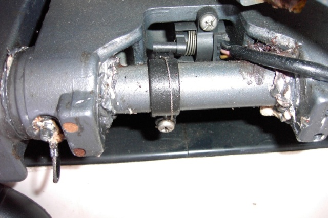

Now onto my Yamaha problem Crook (engine will trim up but not down.... I see that the trim sensor is a known issue and... mine is broken. I will try the C-Weed fix (and then see if there is an improved part). Here is the C-Weed fix:
http://www.c-brats.com/modules.php?set_albumName=album18&id=Image014_001&op=modload&name=gallery&file=index&include=view_photo.php
Sure is great to have C-Brats to help and to learn from Thumbs Up
