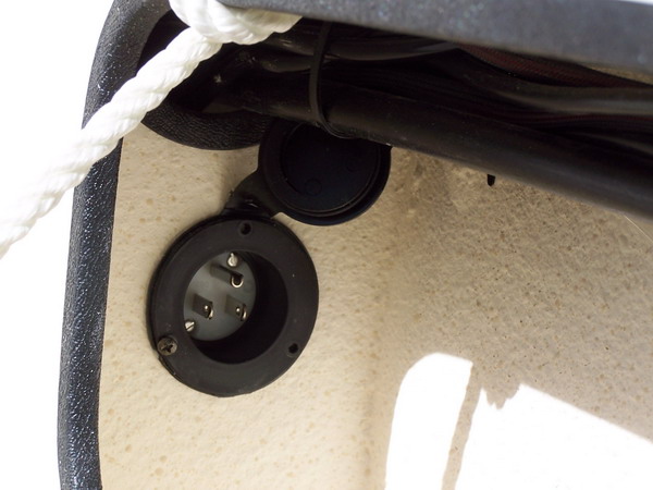

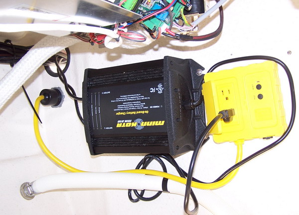

I followed the late, great "Sneaks" simple, low-cost shore power solution and it has worked great for many years.

We use one of these with an extension cord and guest 10 amp charger for our temporary shore power solution. Works for us.
