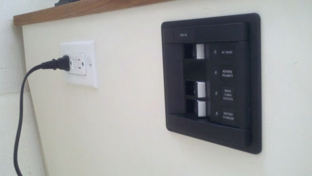

Panel and cabin GFCI under front of helm seat base:

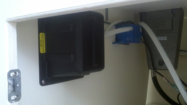

Back of panel inside helm seat base compartment. Note that the wire on the right isn't installed yet. I don't leave wires hanging loose running through compartments!:

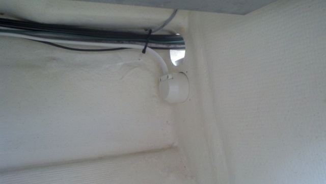

Backside of 30A inlet under galley counter:

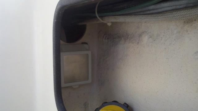

Inlet installed in starboard gunnel shelf through bulkhead:

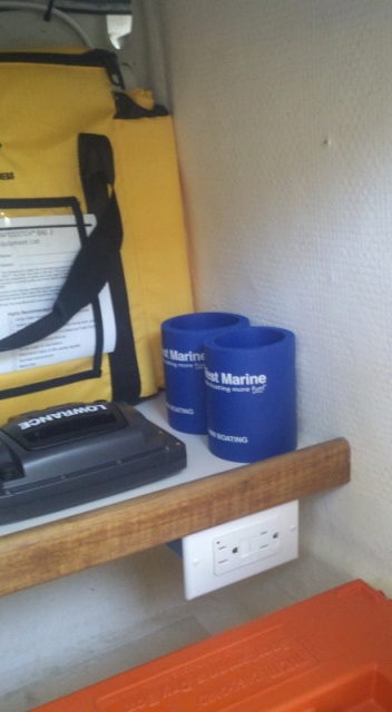

I'll take a pic of the other outlet when I get a chance. The wires from the inlet (10/3 and #10 ground to DC neutral bus) run through the wire hangers (zip ties) along with the house power and motor controls. The first outlet is right next to the panel. The second outlet is in the galley cabinet under the shelf next to the bulkhead, facing toward the opening so it's easy to access but still out of the way. The cable to this outlet runs under that shelf along the back, along to the helm seat cabinet where it runs up and joins the larger bundle. I used some of those white plastic cable clamps to suspend that cable tightly under the shelf so it doesn't catch on things.
Galley cabinet outlet for charger, dehumidifier, etc.:

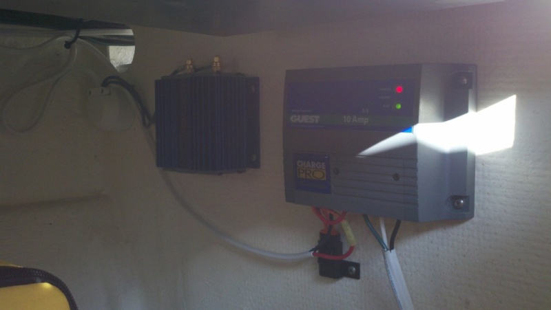

Last week I installed a galvanic isolator. There a 3 types of isolators (as far as I know):
* The cheapest ones are basically 4 diodes, and are completely passive. These aren't up to code since they can quietly fail and open the ground connection to shore with no indication.
* More expensive models provide a remote monitoring panel that indicates when things are working properly, or when the unit has failed due to a short to ground (etc.). The problem is, if the unit fails while you are away from your boat, you can start sending line voltage into the water, start a fire, all kinds of fun things. I want to keep the boat on shore power and not worry about it...
* A fail-safe model has the same basic function as the above two, but in the case of failure of the diodes due to a large current, the unit will end up shorting the input to the output. If I had a ground fault that sent line voltage into the ground wire, and for whatever reason didn't trip a GFCI or breaker, the fail safe unit would ensure that the ground was preserved through and after the fault.
The model in the picture (background) is a GUEST 30A Fail-Safe model 4531001.
The isolator is mounted right next to the inlet. The 10/3 stranded wire from the breaker panel enters the inlet case, but the ground wire does a U-turn and exits the case and connects to the isolator. Another wire from the isolator runs back into the inlet case and connects to the ground stud. I did it this way since there was enough room in the inlet's cable clamp, and I didn't want to cut open the mains cable sheathing outside the inlet body to split off the ground wire.

I installed a Guest 2610A 5/5 charger last week as well (pictured in the previous post). I picked that model specifically because it has terminals for all in/out wires. Most chargers under $150 tend to have short cables permanently installed (i.e. 5' AC cable and 5' output lines).
This model also let me hard wire the charger to the GFCI receptacle below, rather than having it plug in.
For extra safety, I installed inline fuses at both ends of the positive line to the battery (15A). The charger has output protection, so probably not necessary, but I had an extra fuse holder. I used 12/2 stranded wire from the charger to the battery.
