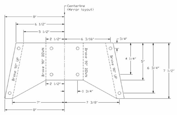

Does anyone have the schematic/dimensions for TyBoo's stainless kicker bracket. I was sure he posted
it on the site at one point, but I'm unable to locate it.
This goes back a few years, but it's a great design and
I'd like to replicate it for a 16' CD. Thanks.
Mark on Mighty Bite
PostPosted: Fri Jun 14, 2013 12:12 pm    Post subject: Reply with quote
Hey Mark, good to hear from you!
It is in the CBTech Library, Outboards and Systems album.
They don't let us buy scrap steel at work or spend any time on government jobs anymore so the chance of me making another one is zilch. Sorry. It's too bad - the things are actually kind of fun to make but I kind of need to keep this job for a while longer.
