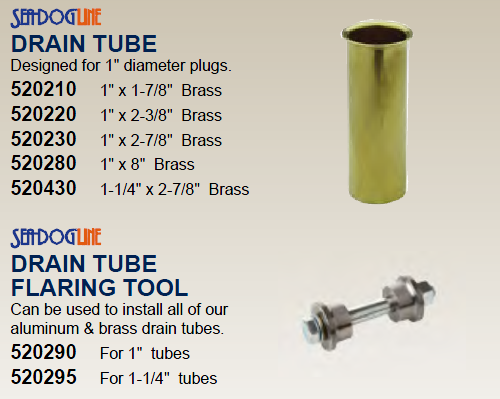

Hello Brats,
I am installing a new drain tube in my motor well as I wait for the flaring tool to arrive I have a couple of questions to anyone who has installed one of these before.
1) Assuming you buy the tube length greater than the transom thickness, how much extra does one leave to create the flange with the flaring tool?
2) My balsa cored transom has been backcut, and filled with epoxy, but I suppose a layer of some sort of bedding compound should accompany the drain tube installation. 3M 5200, 4000, sika ... any thoughts?

My personal choice would be 5200. Although it is "permanent"-the shear strength on a brass tube is moderate. Why would you want to remove the tube, except ot do what you just did. You have already solved any problems.
You want to cut the tube to allow enough flare as there is on the currely fixed side--I suspect 3/16" should be plenty.

Thanks fellas. I agree on leaving about 3/16" to create the flare at the end of the tube.
