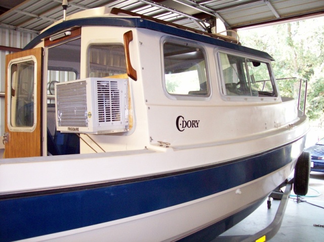

The AC is permanently mounted in the back window. Out of the way and no problem and there when we need it.
We heat the water to the desired temp and then unplug the 120 volt AC before use.
We use a 2500 watt 240 volt element, draws 625 watts at 120volts.

Here's an image of his setup
