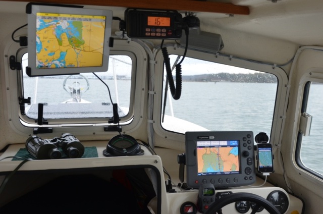

PostPosted: Sun Apr 29, 2012 9:41 pm    Post subject: Reply with quote
This is how mine are setup. It works well for me.

PostPosted: Sun Apr 29, 2012 11:03 pm    Post subject: Reply with quote
Thanks. Actually just before seeing this, I had gone to your photo album and saw how you had your's set up. BTW, I see your radar antenna is right on your roof. Does that work well for you? Colby

PostPosted: Sun Apr 29, 2012 11:07 pm    Post subject: Reply with quote
I like the Ipad. Nice big screen and very clear.

PostPosted: Sun Apr 29, 2012 11:23 pm    Post subject: Reply with quote
The radar mounted directly on the roof works fine. I have no basis for comparison, but I'm not sure what a 6" mast gets you over a direct roof mount.

PostPosted: Fri Oct 05, 2012 8:14 am    Post subject: Reply with quote
I'm not convinced that having so many screens at the helm is a good thing in terms of attention to what's happening outside the boat, but then, I'm easily distracted and definitely have some attention deficit syndrome going. I'm very happy with my single screen raymarine display that puts depth, gps and radar on one screen all at the same time or by soft buttons, putting them on the screen one at a time. The boat pictured has a super clean installation as I look at the picture, and particularly the cabling, but I just looks too cluttered in the pix. I suspect that standing at the helm it isn't actually that cluttered. I'm a big fan of those CD "surround" windows and hate to block any of the view out of them.
I am a big fan of the old fashioned compass, and if you mount one, be sure to do only a temporary mount so you can see the possible effects of electronics and other electro magnetic or ferrite influences on the compass before you screw the thing down permanently.
One VHF bolted below the shelf should be plenty. The back up, in my opinion, should be a high quality waterproof hand held. I'm not tall, but tall enough that when at the helm, the second radio, seems to me, would be in my field of vision.
But, any arrangement that you are comfortable with is the key. There are as many different arrangements as there are C-Brats, and each will think theirs is the best. That is because, for them it is the best.
PLEASE, PLEASE, pay attention to nice clean cable layouts, penetrations an dressing.
You will love your 2007.
