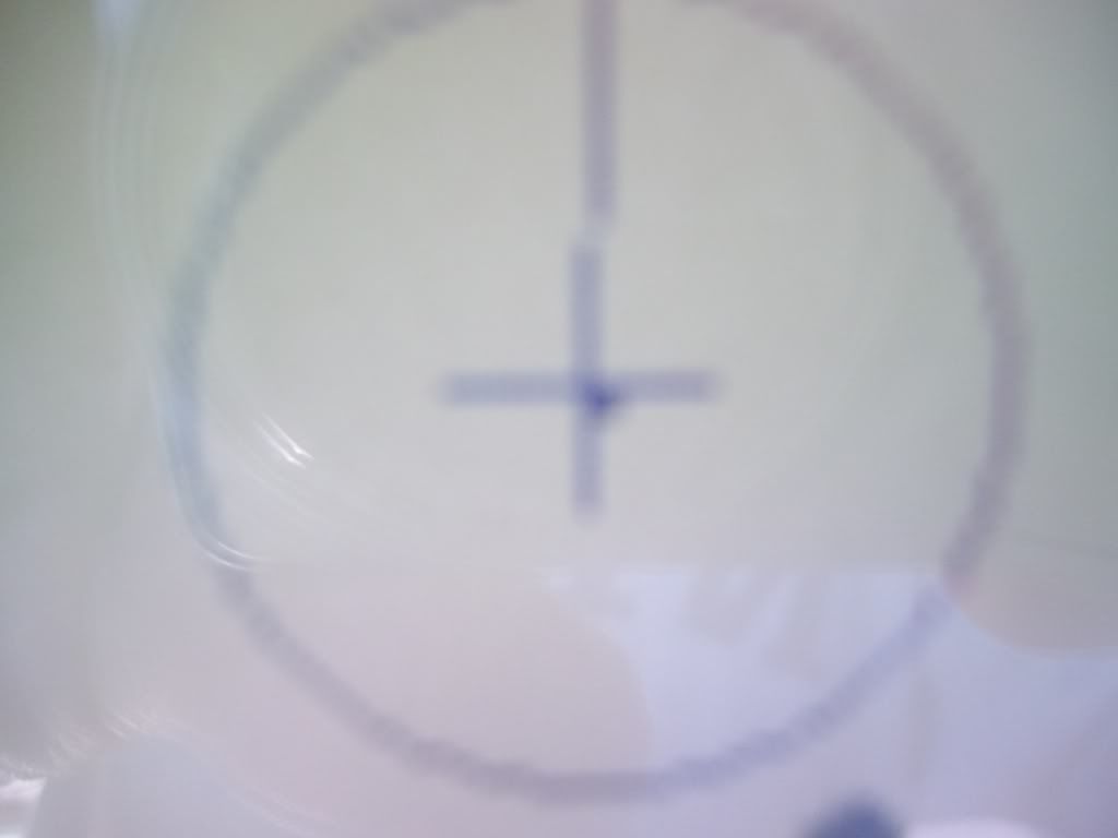

I noticed something on my radar screen this morning when i was adjusting the settings that i cannot remember if they were there before...
http://i1201.photobucket.com/albums/bb355/Tug7/100_0894.jpg
i do not remember the cross hairs being there before and the bearing line and cross hairs do not match up exactly. I wonder if i messed things up?

You didn't break anything. Try moving the EBL around--it may be just off a degree or so. Also the X can be moved, as I recollect-so try moving that

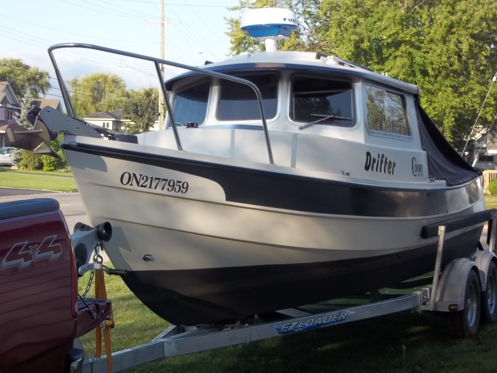

Taken 16/09/12 Furuno 1715 on a 5 inch SeaScan Radar mount
http://i1201.photobucket.com/albums/bb355/Tug7/100_0907.jpg

PostPosted: Sat Sep 29, 2012 7:03 pm    Post subject: Reply with quote
I ended up removing the pedestal, did not like it on my boat. Mounted the radar on a Seaview 4 degree wedge directly on the roof. painted the radar base white using Krylon Fusion Plastic paint. Monday i will be changing the Furuno letters from blue to black and will post some pictures. Question is : will the Cable Cam from Blue Sea Systems work on my C-Dory's roof..the roof's thickness is only around 1/4 inch or so..that leaves doing any undercutting out of the question and the screws really will not be very effective. Tug
Posts: 3599
PostPosted: Sat Sep 29, 2012 7:29 pm    Post subject: Reply with quote
It looks like the radar is inclined up at the front. I always thought that one installed the radar so that it would point slightly down, to compensate for the rise in the bow when underway/planing? I would think that pointing down would give you a better look angle when that bow comes up, so that the radar would be level and could see closer to the boat.
Any comment?

PostPosted: Sat Sep 29, 2012 8:35 pm    Post subject: Reply with quote
Boris . the radar is now slightly inclined at the front, i haven't posted any new pictures yet, will do that when i get my new letters.Tug
