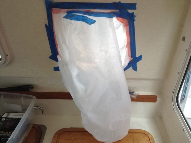

Taped a bag inside (thanks Valkyrie!!!) and folded the top over before taping-this lets it be removed later without spilling.

Check your bag inside from time to time to be sure you haven't poked holes in it (I did). Repair the holes to keep the interior free of glass bits. If you're working in the cuddy, I learned the hard way before to remove the cushions first, then clean up thoroughly after the work. Otherwise, you'll have an itchy bed forever more.
Removing the bag. Look how nicely the dust is piled up above the tape, and you literally just remove a bag of dust from the interior.
