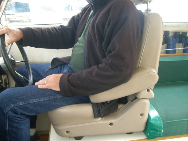

I just installed a new seat on my C-Dory 25 Soulmate and do I love it!!!
I bought the seat off of Craiglsit for $100 and spent an afternoon installing it.( A few trips to the hardware store to figure it out...but definitely worth it). I believe the seat is from a newer Honda. I posted three pictures on the Interior photo site. Two pictures are on the bottom on page 7 the last is on page 8.
Wish I did it years ago.

It sure looks comfortable. Would you be able to elaborate a bit on how you did the mount, what you like or dislike about it, etc.? I take it you still fit behind the wheel comfortably? (No comment on your shape; just that it seems many replacement seats that look like they would be great end up being too high or too close to the wheel or etc..)
Any other clues as to which actual seat it is?
I am pretty sure a different or modified helm seat is in my future, so I'm really interested in yours.
Glad you started this thread!

I realize this is asking for a lot, but I would be very appreciative if we could see a photo of someone sitting in that seat with hands on the wheel, as if underway. For some reason in the photos I can't quite visualize how it could work, and yet obviously it does, since you love it Thumbs Up.
And the seat itself looks so comfortable and functional. After all in general, just about any car seat is miles ahead of the "typical" boat seat, comfort wise (Stidd chairs and the like excepted, but they would have a hard time fitting on a C-Dory and they are quite expensive).

Hi Everybody...
I guess I am the mystery seat guy...sorry I didn't explain the photos when I added them to the site..
I will try to get a photo with me sitting in the seat. When C-Dory built our boat we had them recess the sink and the stove so we could have the extra seating for our whale watching business...
I bought the seat without really knowing how it would fit or how I would install it but for $100 I felt it was worth it . I have put almost 2200 hours on our boat and it needed a seat up-grade(should have done it years ago). I checked out a few wrecking yards and I couldn't find anything that was decent, but Craiglist worked just fine.
The seat is still able to slide forward and backwards on its tracks but I really don't have to use that to get in and out. The seat raised my height up about 5 inches so I built a small foot rest that sits on the foot locker.
Really I think almost any bucket type seat could work, it's just a matter of figuring out how to install it. The black rubber pads cost me a dollar a piece and I drilled a hole through them to run the bolts through and I believe they also help smooth out the ride and made the installation better.
I'll try to get a new photo in the next few days and I will explain it this time

I've added some new photos of my seat on my Soulmate photo page....
Hope you can figure out a new seat for your boat because it is really a great improvement
bill
PostPosted: Wed May 30, 2012 9:25 pm    Post subject: Reply with quote
Thank you for posting the additional photos - it's really helpful to see the scale with you sitting in it Thumbs Up And you get more stowage under the new footrest. If I'm seeing it correctly, it eliminates being able to have your upper legs centered under the wheel, but it sounds as though you find comfort well worth it.
